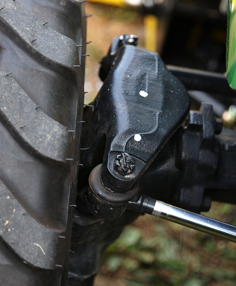

would tire chains work on the front or is it to close to the steering parts
/ 2570 or 2520 fronttire chains
#2
is suppose to be 2520 or 2720
/ 2570 or 2520 fronttire chains #3

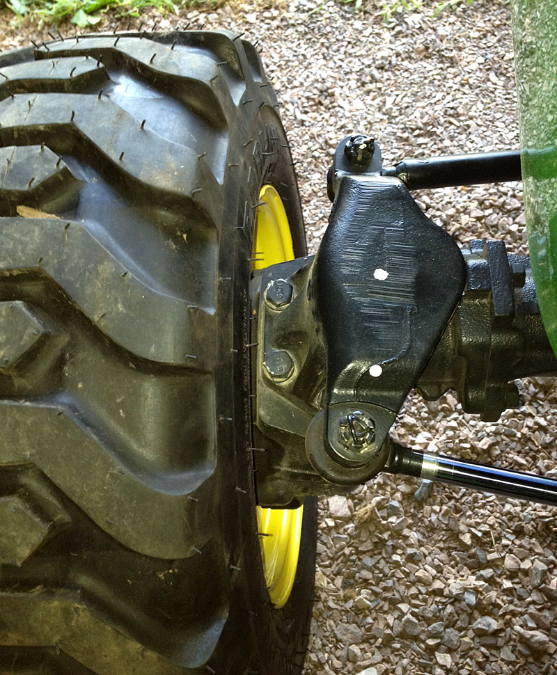

JD sells spacers for the front to give you clearance. Otherwise I believe it is too close to the tie rod end.
/ 2570 or 2520 fronttire chains #4

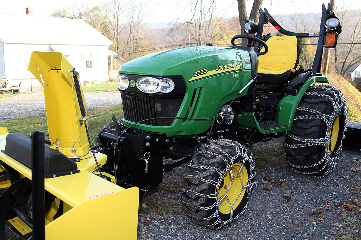

I have front chains installed on my 2720. I installed the front spacers that JD sells otherwise there is no room.
Clearance without spacer
Clearance with spacer
