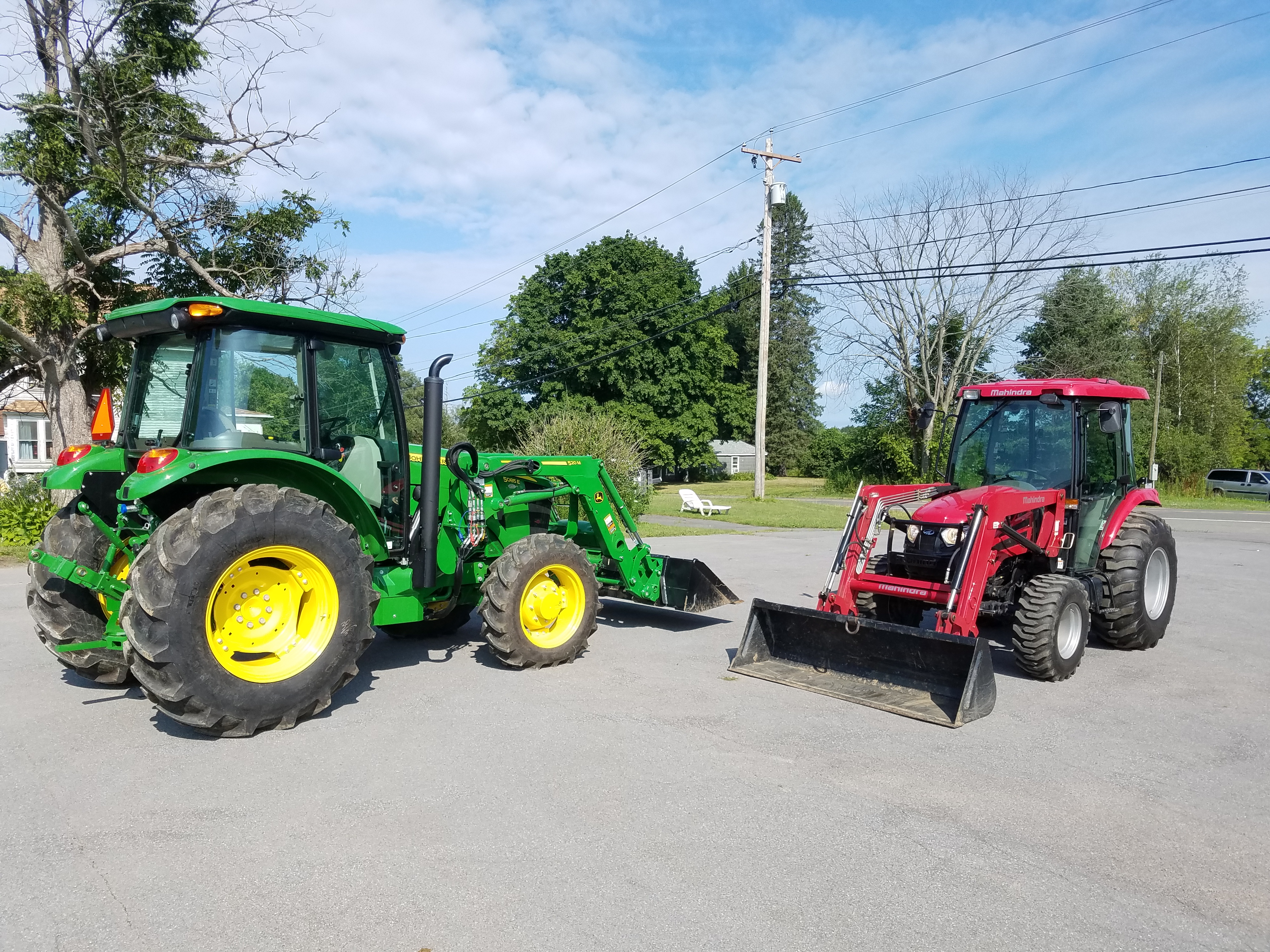

Update. After months of it being in the shop and countless reoccurring oil leaks I decided to trade in the 2555 for a new John Deere. 20180728_094059.jpg20180728_094059.jpg
   / 2555 Mahindra overheating and leaks #14
Nice machine. You will get good service out of that unit. More pictures please.
   / 2555 Mahindra overheating and leaks #15
You did the right thing. New machine looks very nice. Enjoy.
