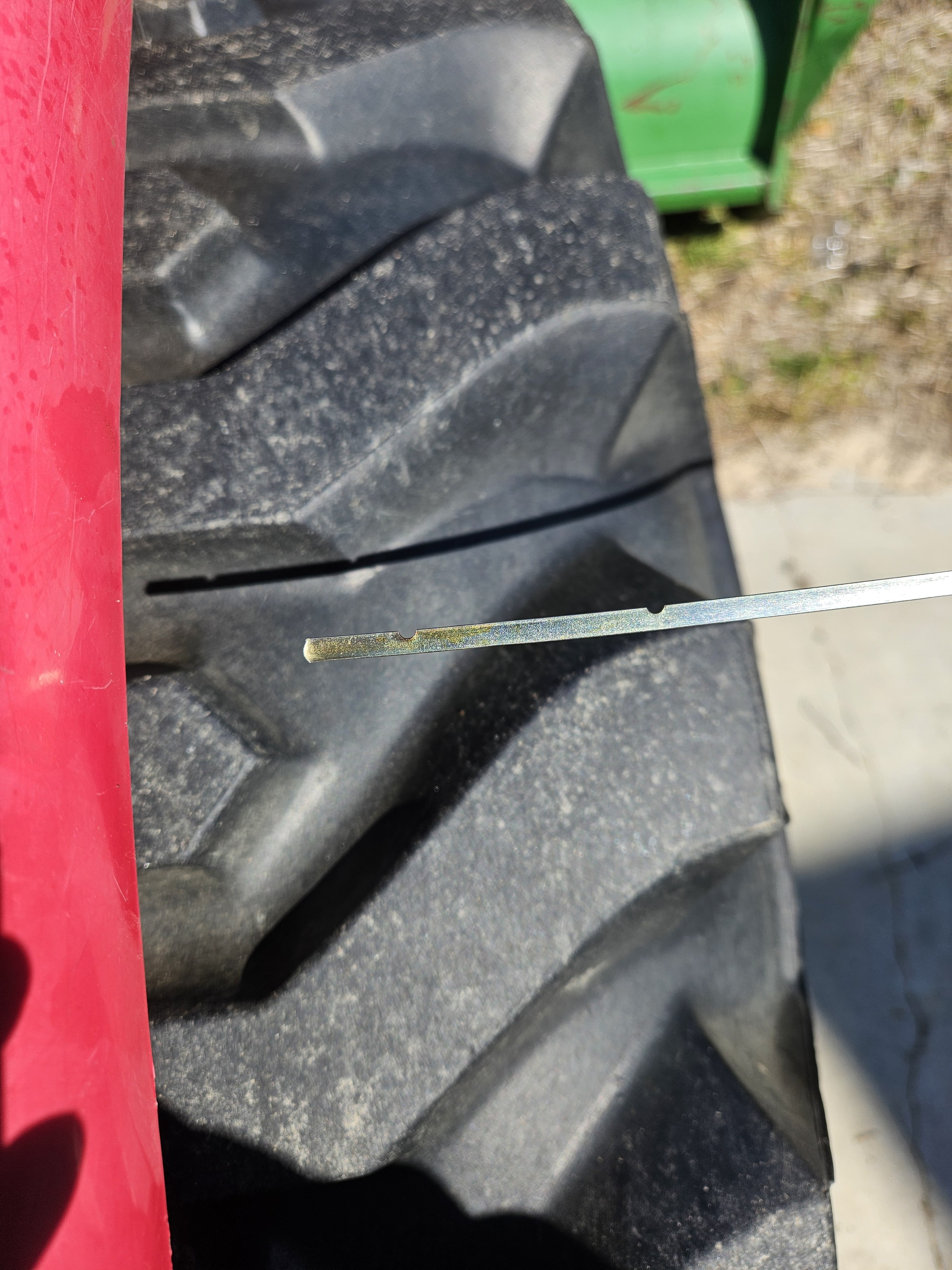

/ 2545 foaming behind engine
Oil looking good. Also drained the fuel filters. Lower one had sla bit of algae in it, the upper just had a little trash.

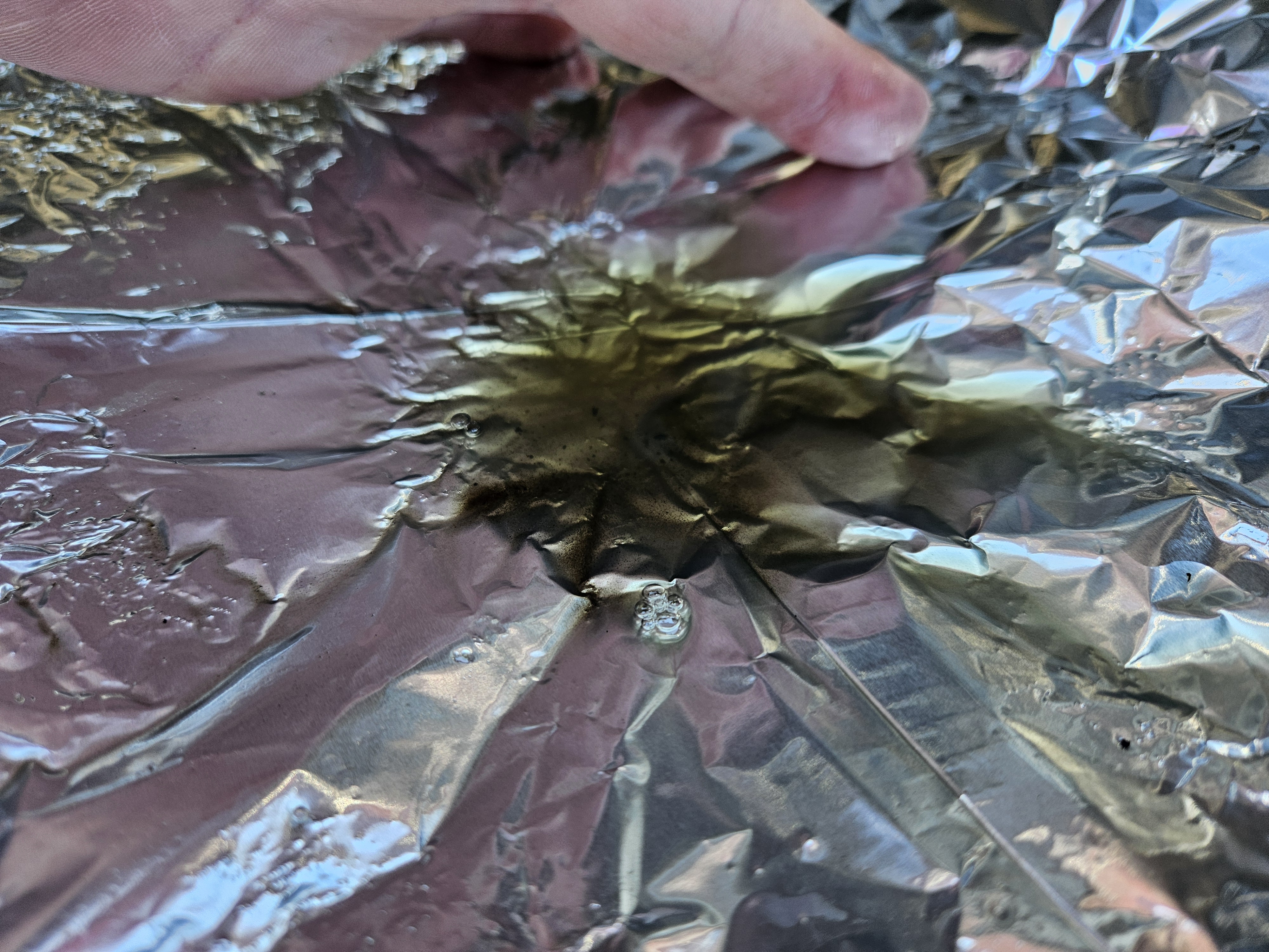

I'm having trouble IDing the fluid.. it's really oily but smells like old diesel.

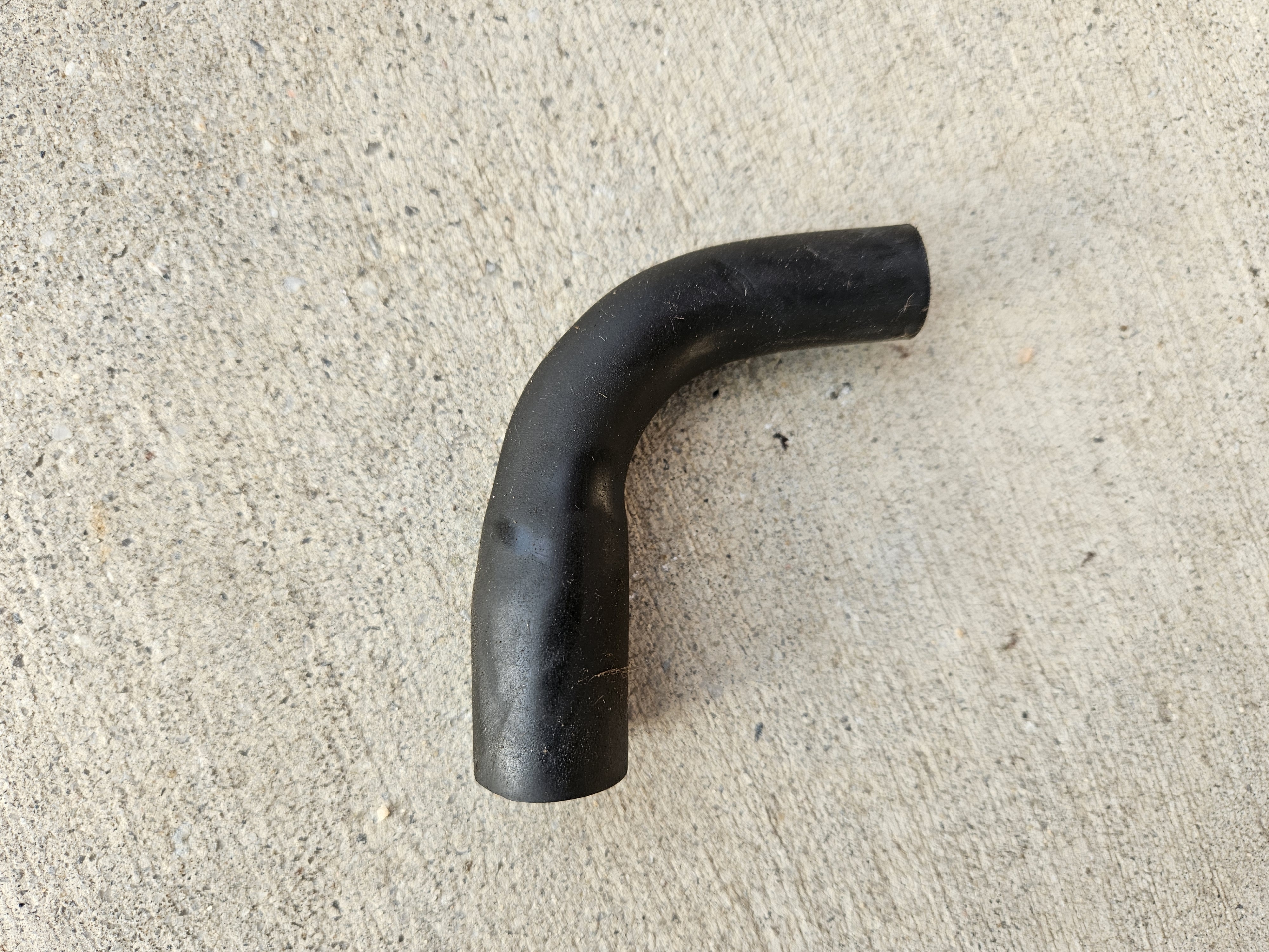

The culprit is this 90 degree elbow that sits between the engine and the firewall, it slips onto a nipple on the top of the transmission. I was tugging at it with some long needle nose pliers (trying to trace it) and accidentally pulled it off, I have no idea how I'm going to get it back on there. :| I guess the fluid is hydraulic fluid and it's from a vent.
