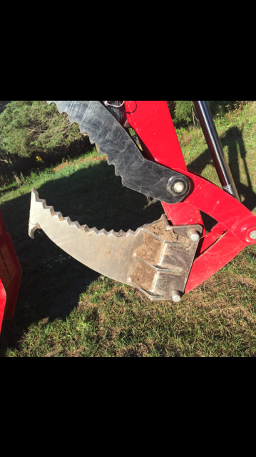

oh, and a photo of the finger on (had a guy ask about that)

BTW I like your ripper tooth. It looks meaner than than my Brotek tooth. Looks like it would take a better bite out of tree roots and stumps.
/ 2538 Maintenance Question
Thanks df. I will take your word above... much appreciated. Ripper tooth works well. Doesn't replace dynamite but with a little touch you can pick away at them. I am working on a tool box design now if I can find a way to mount it securely without blocking view and no drilling. More on that once it gets off the ground
