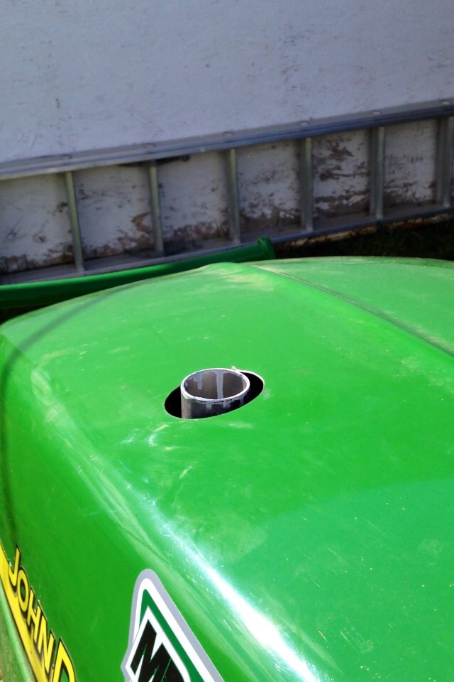

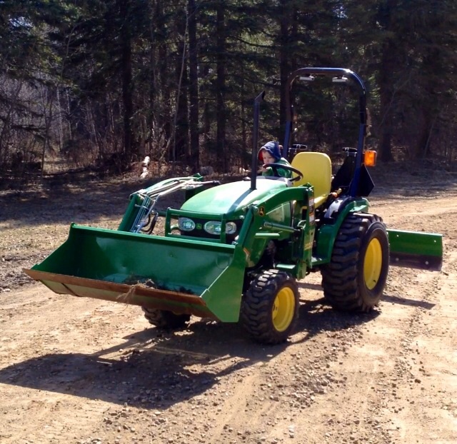

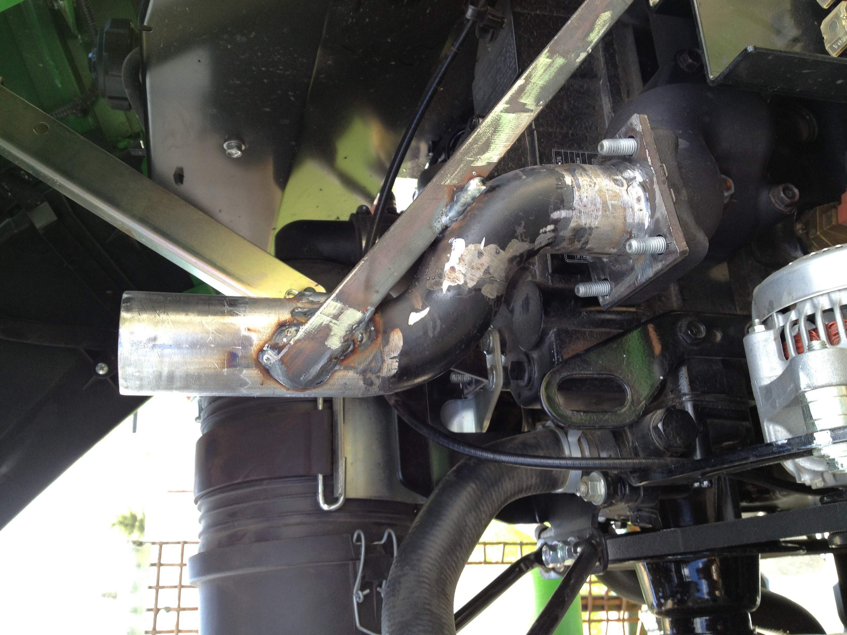

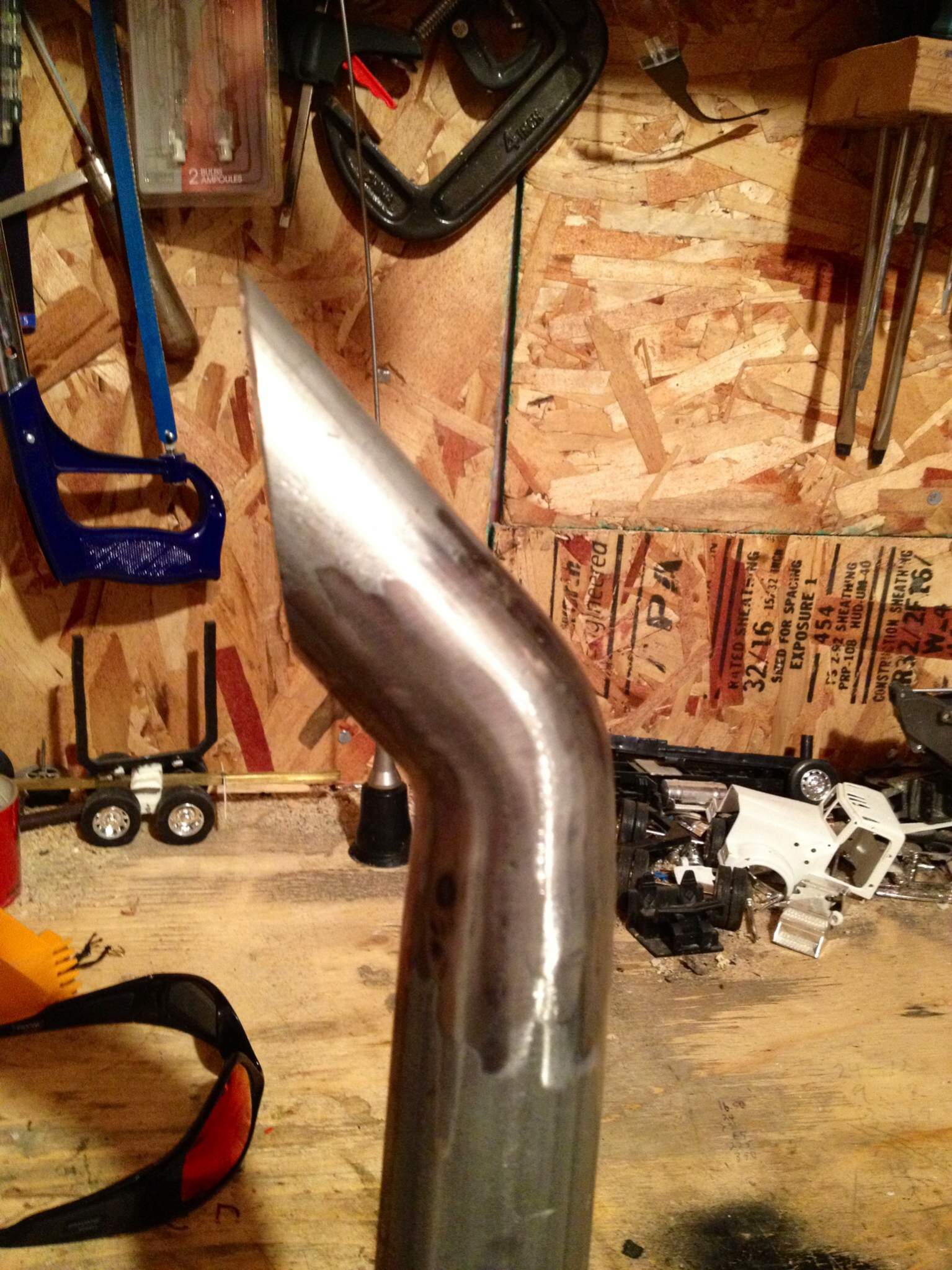

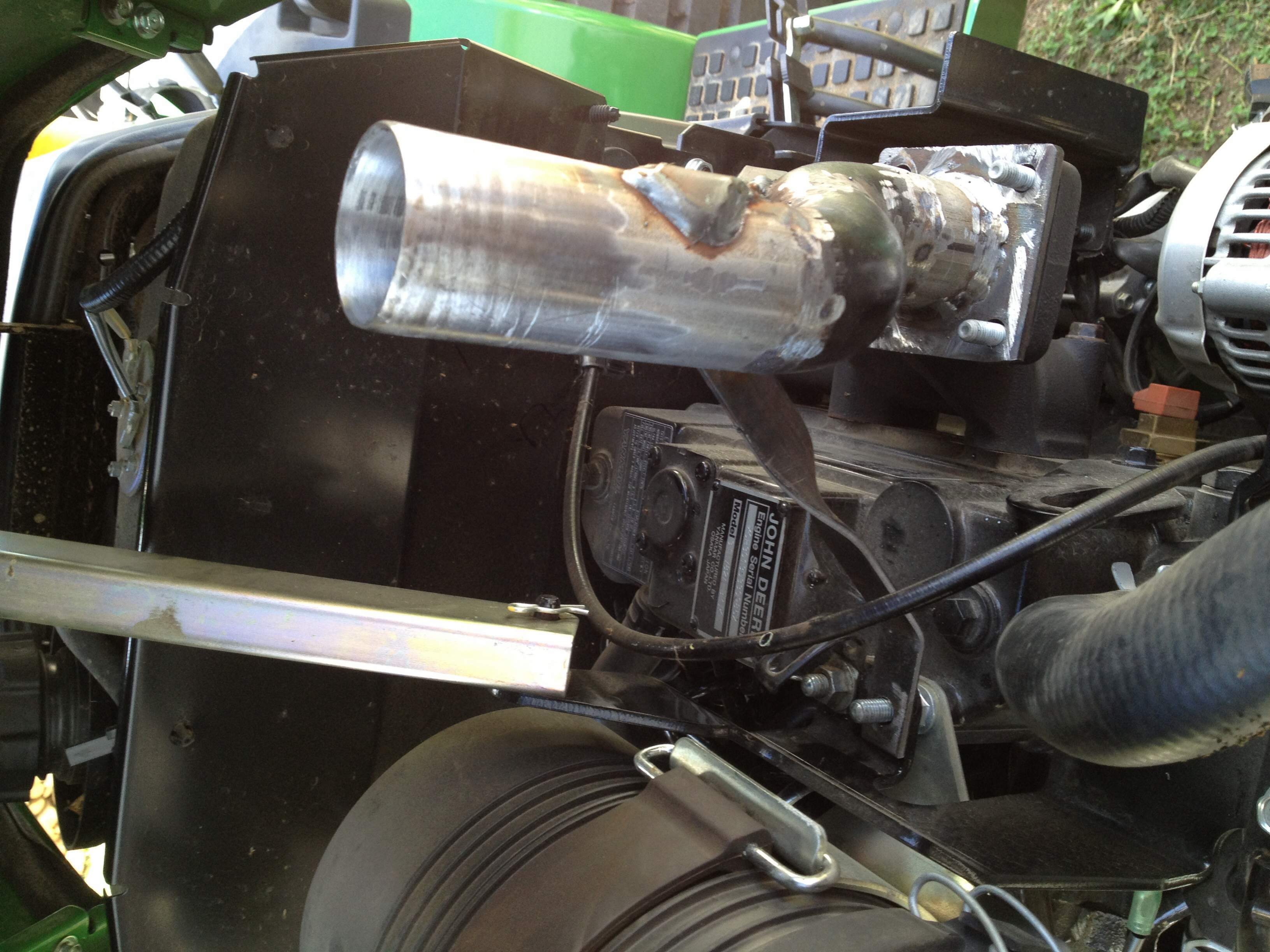

So excited I finally figured out how to post pictures. I thought you guys might like to see the exhaust I built for my 2520. I know some people don't like the hole in the hood and to be honest I almost cried cutting into it but I'm happy with how it turned out. image.jpgimage.jpgimage.jpgimage.jpgall powder coated and done. image.jpg

Straight piped, no muffler? Thought about the same thing on my 3005, how is the noise level? I'm tired of the exhaust soot on my left loader arm.
/ 2520 vertical exhaust.
Sorry I'm not the best at taking before and during pictures. The whole stack is a homemade muffler. I rolled punch plate,put a washer on the end and stuffed it with stainless scouring pads, these were a buck for 4 at the dollar store. It is just a tad louder than stock but no dirty loader arm and rather than smelling diesel exhaust all day I just get the occasional whiff. Don't get me wrong I love the smell of diesel smoke, but when your working in close quarters like the sawmill or cutting firewood where I do it gets a bit much. Besides it just looks like a tractor now.
/ 2520 vertical exhaust. #4
Looks good!
It's funny that I paid more to have an exhaust that goes down, instead of up!
Does it get in the way of opening the hood?

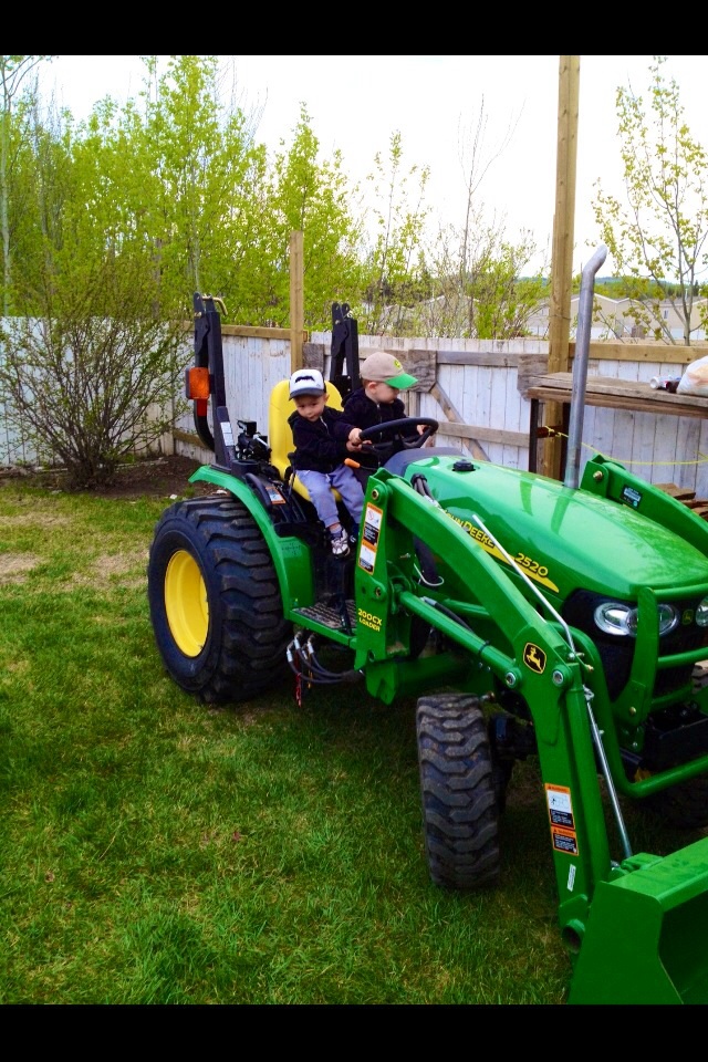

image.jpgA simple twist of the wrist and it pops off. Oh and it sounds awesome strait piped but I do have neighbours, and I'm young I need to save a little hearing for my old age.

Nice! It looks like you did a good job getting the pipe centered in the hole too.
