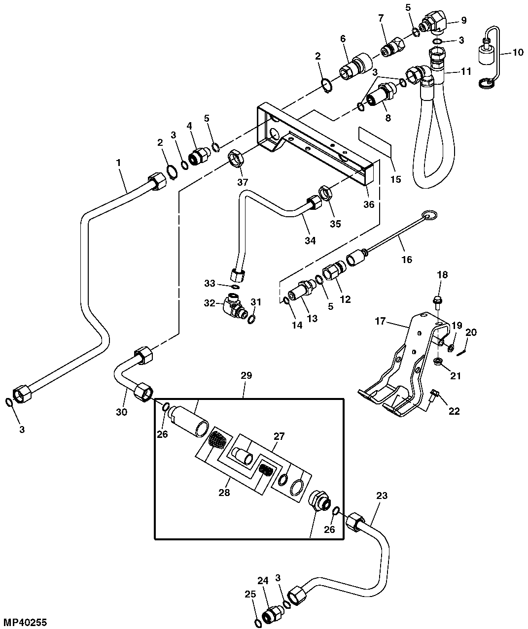

I purchased a 2009 John Deere 4105. I need to install a hydraulic top link. There are no rear remotes on the back of the tractor and John Deere said it can not be done. I find that hard to believe. Could anyone suggest how I go about installing a rear remote on this tractor.
   / 2520 - Rear Remotes Added #26
The Power Beyond Kit for the 4105 is JD p/n LVB25505. You will probably need to talk to the sales person (not the parts counter) to get it.
Attached is JD's drawing of the PB kit for the 4105 from their parts website.
After that you add a valve as shown elsewhere.
