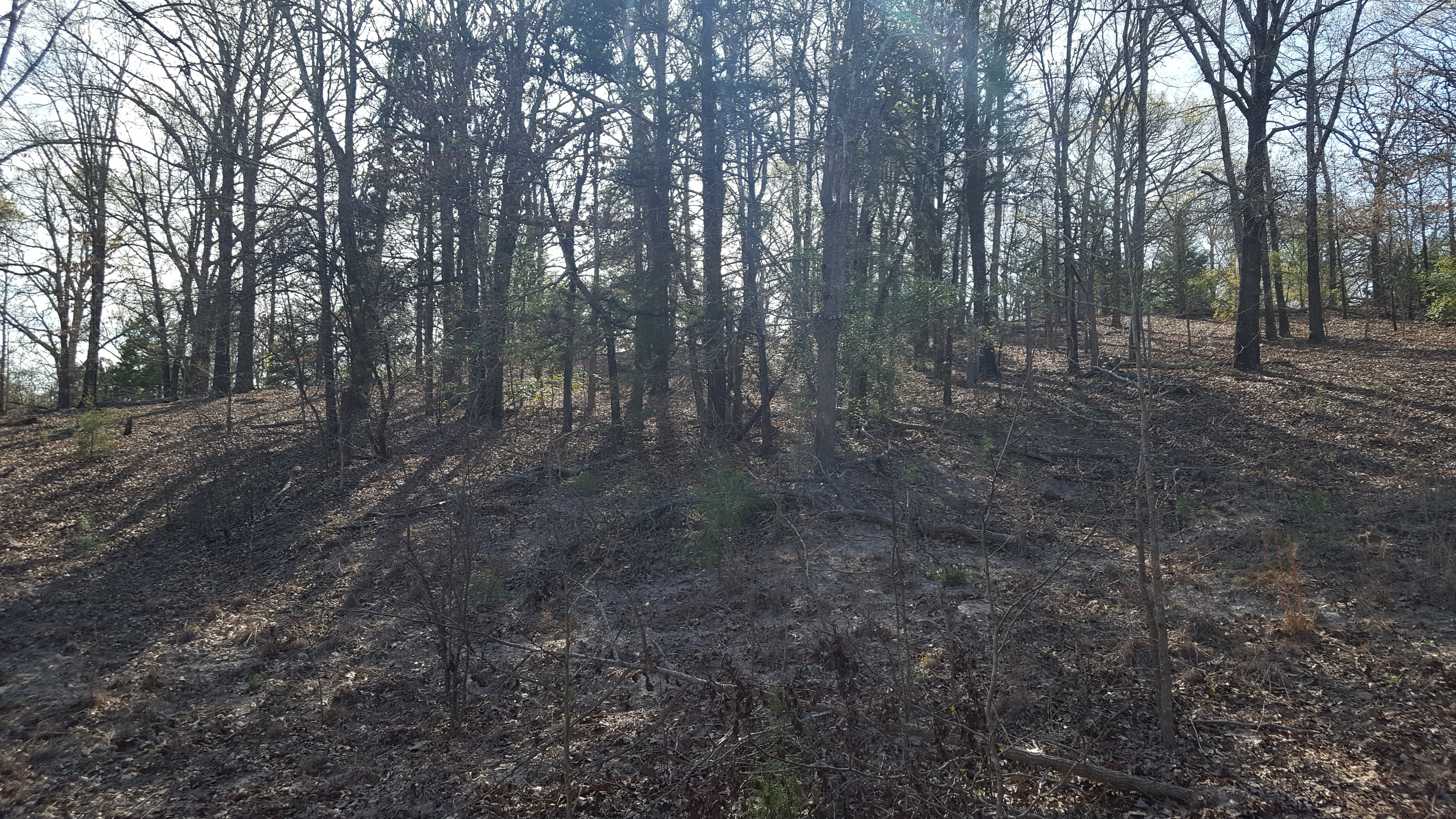

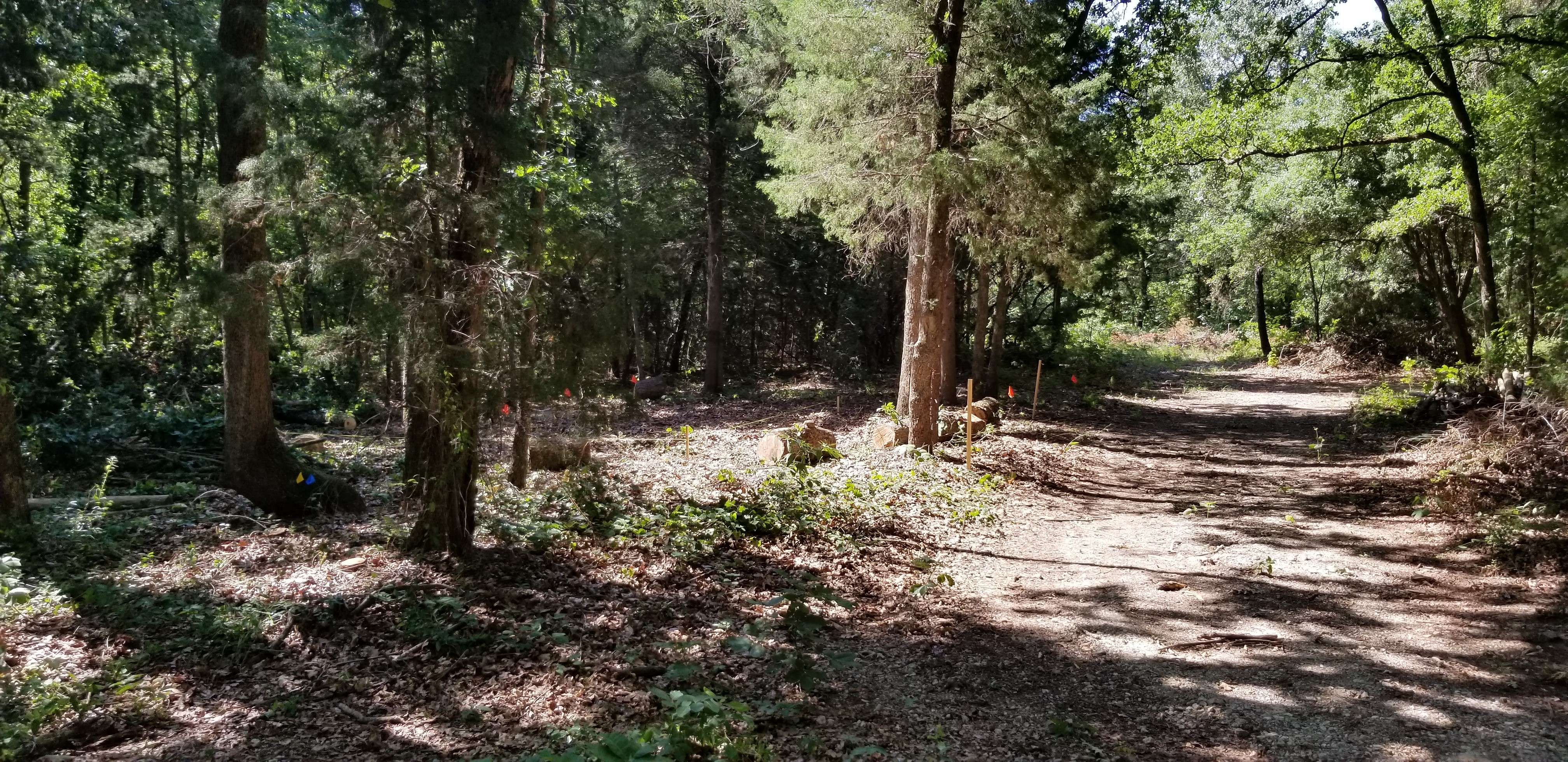

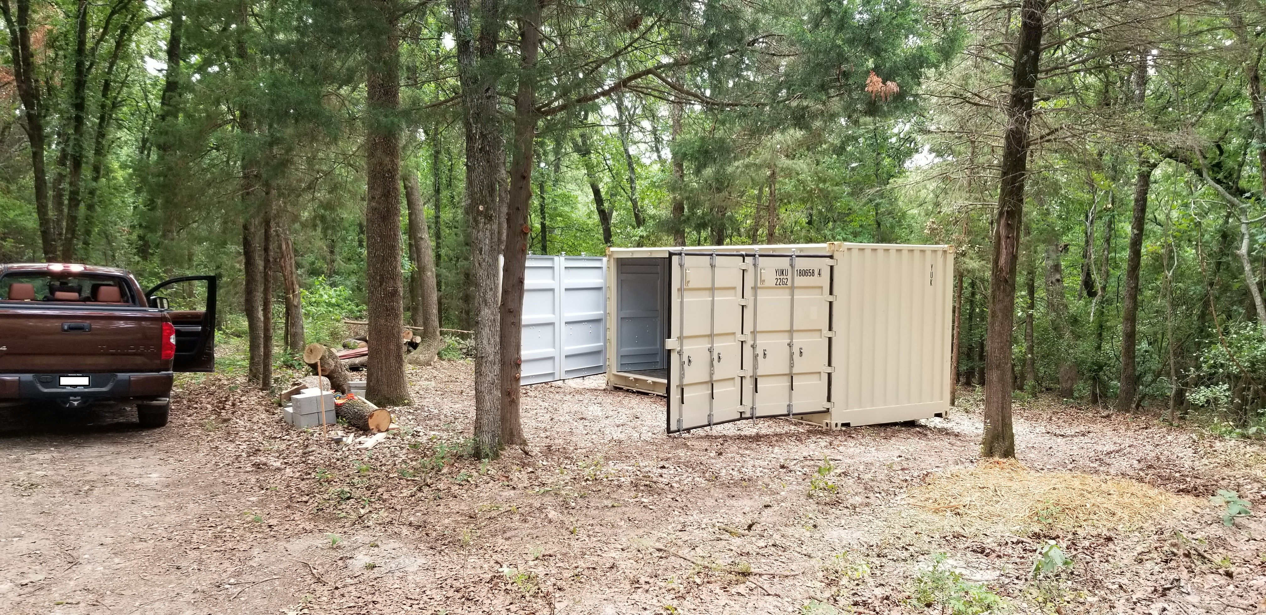

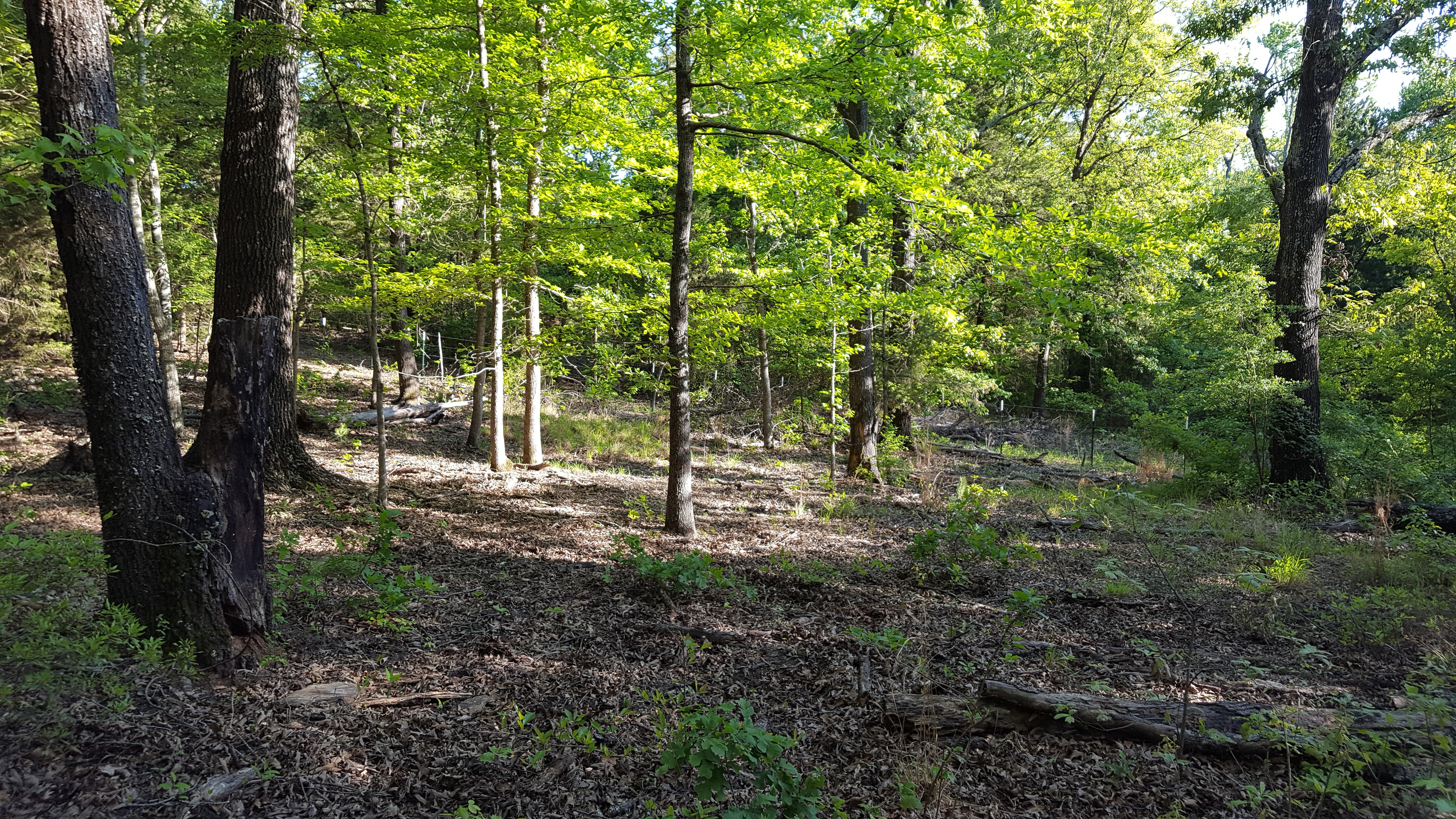

#36
Lets see if these pics work...

#40
Not arguing that I didn't mention logs of a certain size. As you can see from my pictures, but a few trees are larger than 18" in diameter. I was able to move those partial logs in the last picture rolling by hand. Hard to imagine a tractor from my list couldn't lift and/or drag two or three of those at a time. I can live without cutting down the biggest trees on my land. Just trying to keep this conversation grounded and not scope creep into an 100 hp logging tractor because I mentioned moving logs. Because the conversation becomes irrelevant to me once the tractor of discussion is out of my budget. My life will not revolve around the tractor, but I do want to make the best selection given my budget.
