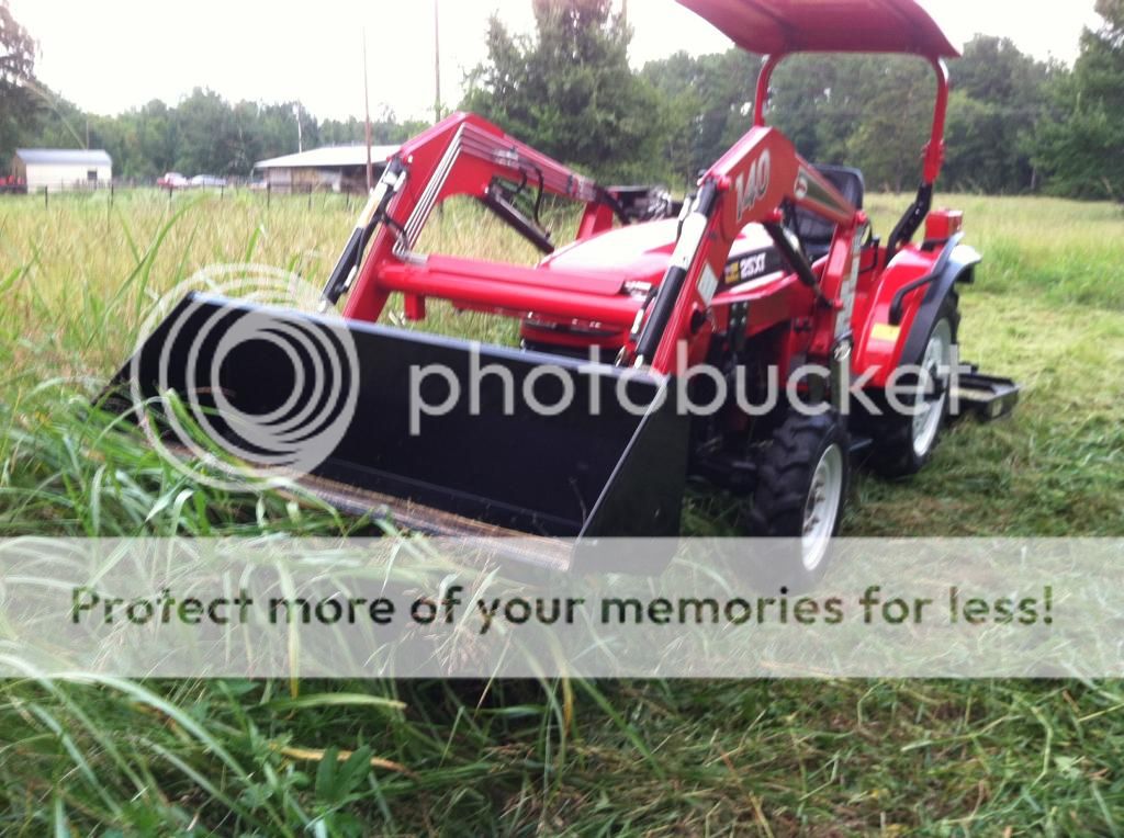

I have a nortrac 25xt with the koyker loader and I really like it so far...32 hrs...northern tool in tyler has been great(see my post).....nortrac has been great....had a battery cable go bad...found a local guy to fix it and nortrac paid for all the service, I think he has reached an agreement with nortrac to service this area...
call tom at nortrac and visit with him, if you like, he's the nortrac vp.......very nice man.....sent me my make ready list via email........
I use it for bushhogging, road leveling, and brush moving....
here's some of the "stuff" I had to cut the first time.............
added the tooth bar from yankee warehouse....$230....delivered..... loving it....
4 wheel drive is awesome....still learning about the unit....I would recommend it for most small acre usage,,,i have 12 acres....
