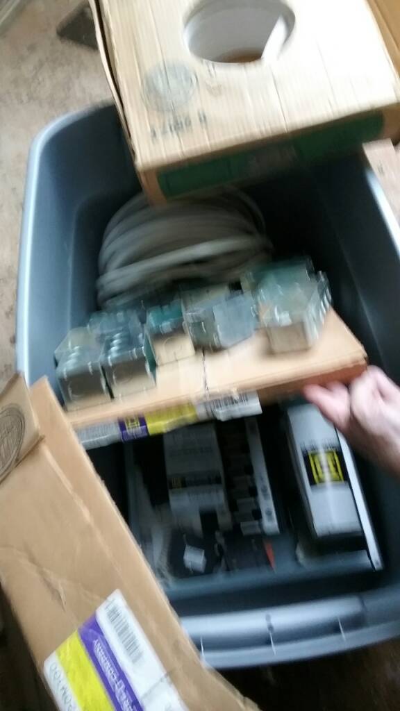

Thanks...at my age, I think I'll forget the conduit! My neighbor has loads of electric stuff, he Dad passed and he inherited Square D new stuff.

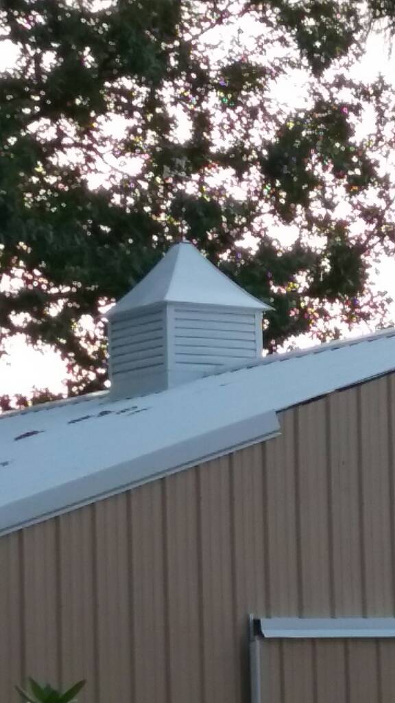

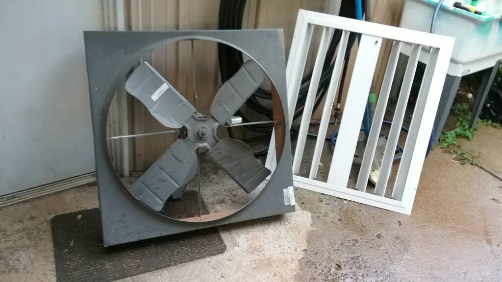

He just gave me a 100 amp box, 30 asst. breakers, 250ft 12-2, 250ft 10-2, 500ft. Cat 5e, phone line, boxes, switches, outlets, a 36" whole house fan I'll put in 36" cupola.
I have a 30-36" ditch dug. I have the 3/4 black water pipe in, I'll just pack that in with 10" fill then cables.
I'll put box inside building a few feet in, lead in wire in conduit just ground up to box. Out of box I'll run metal conduit everywhere for 10-2 or 12-2. I'm not sure about lights yet. Maybe an outdoor light up at peak, then led ones inside. I'll figure as I go. 20190601_194250.jpg20190601_194345.jpg20190601_194414.jpg
