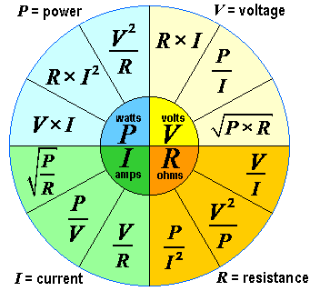

You are mostly correct, except the first line. Watts does NOT equal ohms times amps times amps. Watts is simply volts times amps.
Not correct. Power can be calculate several ways
P = V X I
P = I X I X R
P = V X V / R
Look it up.
/ 240 or 120 Volt? #34
P = V X I
P = I X I X R
P = V X V / R
Look it up.
He IS correct. What is THIS^^

I is current. Does that answer your question?
And current is amps.
I x I x R
is the SAME as
Amps x Amps x ohms
Yet you say Amps x Amps x Ohms is wrong, and I x I x R is correct???:confused:
