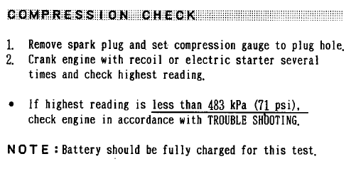

Feb 23, 2022 / 240 garden tractor, compression test? #1 J joea99 Platinum Member Joined Sep 8, 2014 Messages 692 Location Marbletown NY Tractor Kubota B21, JD 240GT Anyone know what acceptable compression is on the Kawasaki engine in the 240 Garden Tractor? Is 100 too low?
Feb 23, 2022 / 240 garden tractor, compression test? #2 R Richard001 Veteran Member Joined Jun 25, 2015 Messages 1,861 Location Plymouth, MN Tractor Jd lx178 According to the service manual, 100psi is good.
