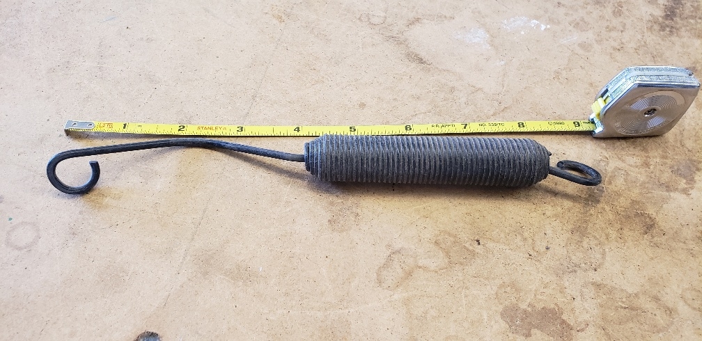

When I bought my current house I negotiated to keep the seller's 445 garden tractor, which came with a 60" mid-mount (set for mulching) and a two-way (hydro) front snow blade.
This part was in the tractor shed with some filters and such. Dunno what it's for, have never wished for it, but I can't bring myself to throw it out.
Does anyone know what this spring is for?
Thank you in advance!

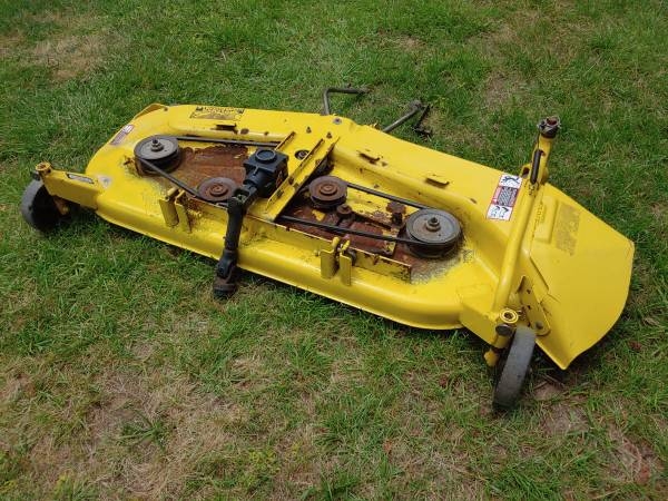

Goes on the front wheel of the mower deck. It helps keep it aligned when mowing.
/ 2000 445, mystery spring? #6
That was my first thought also....but it's been a lot of years since I seen one so I wasn't 100% sure.

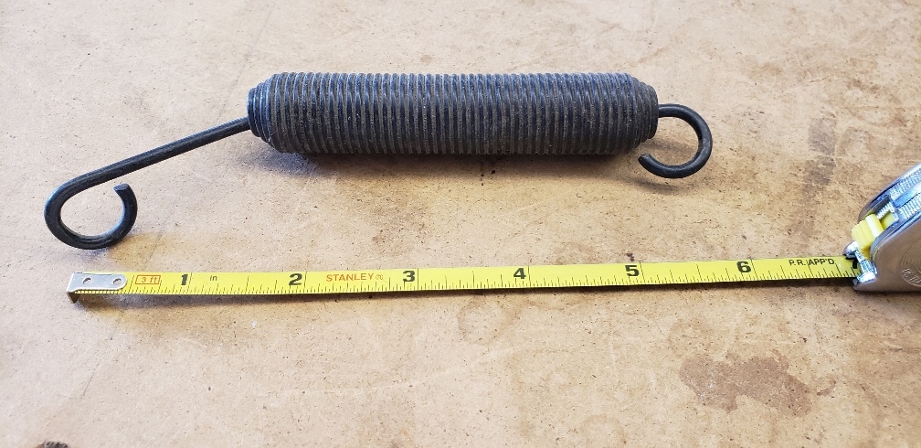

I think we have the same spring.
Do your 2 ends slide in/out of the coils like this?
Mine came off the right front mower deck wheel of an old 400 series with a 60? inch deck.

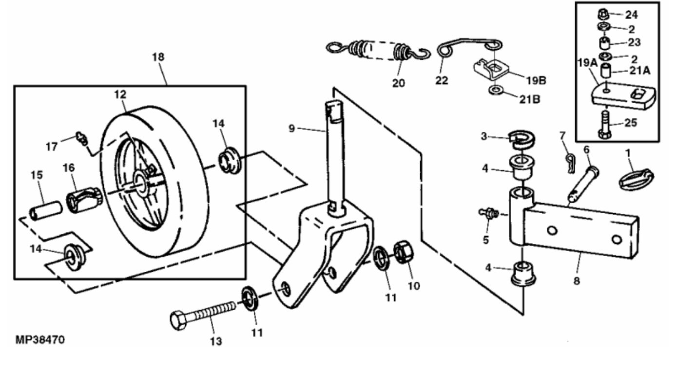

/ 2000 445, mystery spring? #9
Here's a picture out of the parts manual.
/ 2000 445, mystery spring? #10
Yes. Mine slides out like that. Glad I could help.
