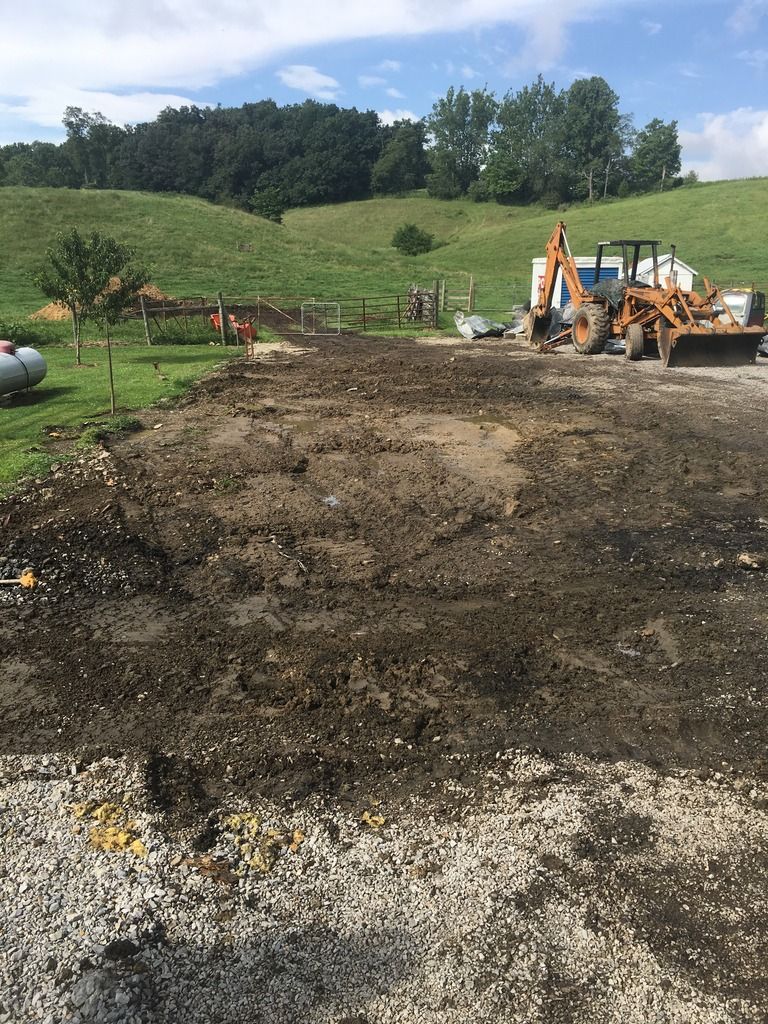

Finally dried up enough to remove the last of the concrete. When it dries up a little more, we will excavate the top soil and start working the drainage out. The original concrete appears to have been poured directly over topsoil with no rebar. None of it ever cracked.......strange.
   / 24' x 50' Shop Build in VA #35
The number one reason concrete cracks is from the amount of water used when mixing it. Adding water increases volume. When the water evaporates, then amount of volume decreases, and you get cracks. More water, more cracks. Less water, fewer cracks. Rarely does settling result in cracks. Settle soil under a slab will either create a void, or it will break off and give you a lot more then just a crack.

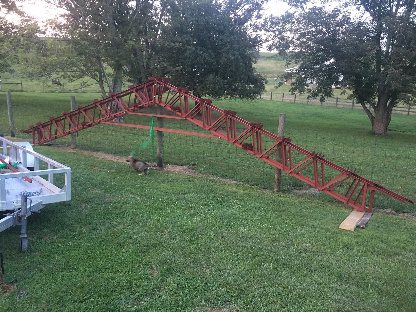

Here's a pic of the first couple of trusses assembled. and stacked against the fence. You can see my new GSD puppy having a little fun at the expense of a piece of strap.
I will be laying out my batter boards today to get ready to cut the pad area down to the subsoil. To get ready to install the Perma-Columns and have the floor poured. My concrete contractor and I agreed on I would set the form boards around the bottom of the Perma-Columns and have the gravel dumped in the pad location. Probably will wind up with 10-12" of #57's. He will level the gravel and compact them, place remesh and pour a 30' x 30' x 5" thick pad of 4000 PSI concrete for $3000. I thought the price was very fair. I will be photo documenting that process as well.
