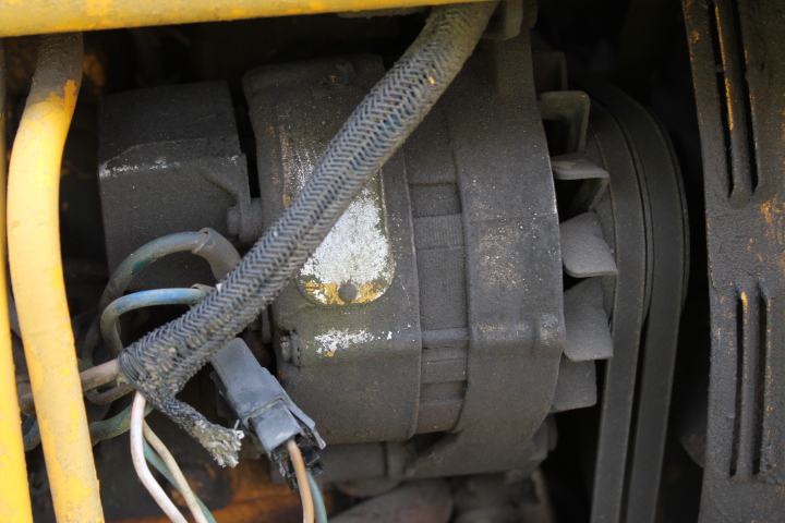

Under Deere parts it only lists an Alternator and that to me is what it looks like. I know the older systems were generators, but I don't think this is.

From viewing parts catalog it should have a Motorola alt. Possible faulty regulator or diode causing non-charging. Have you checked for drain as 24 V system have a history of voltage drain. Brush dust is starter is the #1 cause of drain.

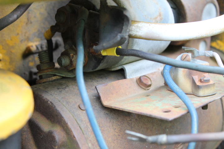

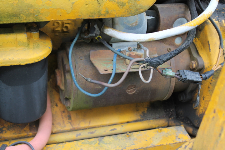

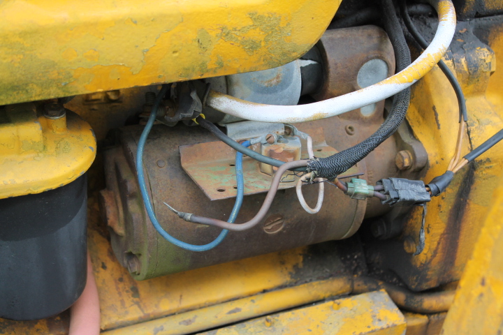

These are the pictures.
/ 24 volt system not charging #6
Looks very similar to a Motorola alt. What indicates it's not charging?? Relatively simple to find out if it's charging by testing with a volt/ohm meter.

Looking at those pics, I would suggest you hire somebody to do some wiring maintenance.
It would fix your current problem and help prevent future ones.
/ 24 volt system not charging #9
Very good point Willl. I only looked at photo with alternator in it. But with those loose wires at the starter solenoid I don't see how starter will engage.
I doubt that 1 wire that is not connected is the issue, doesn't ever have any voltage on it. I owned the machine for 8 years, and going by the guy I bought it from it was like that when he bought it, and he owned it for 20 years. None of the wires have been touched since I bought it. Starter etc worked fine and still does all but the fuel gauges work. The problem is a lack of information on this set up. The local Deere dealer hasn't been much help, they had a fire a while ago and lost all of their tech manuals. The guys that work there are not familiar with the 24 volt set up either. I wouldn't mind having them do the work, but I'm not going to pay people to fumble around till they get it.
If I had a proper diagram I could redo this myself, but each one I have found is different than this set up. The tech manual I bought only covers 12 volt set-ups.

I'm not familiar with the 24 volt industrial system with alternator, but... Looking at the photos, the loose brown wire at the starter definitely needed to be connected on the 3020. It should be connected to a second circuit breaker the same as the one with the blue wire. Then the other terminal of the second breaker got connected to the small terminal on the solenoid closest to the engine block. That sam terminal should have a second wire that connects to the large post on the back of the starter where the other battery cable connects.

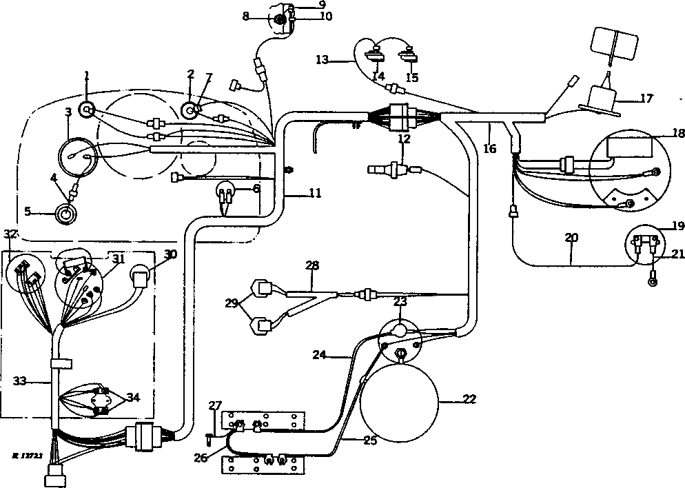

R12723_________UN01JAN94.gifThe circuit breakers at the starter were not original equipment. They were an add on kit that was provided when wiring harness was replaced. Without the breakers, there was no protection in case wiring or starter shorted out. Many of the original 24 volt systems burnt up the wiring until the circuit breaker kits were installed. Without that brown wire connected, the charging system can't work properly, half the lights shouldn't work, and the fuel gauge won't work. I am attaching a picture of the part catalog schematic of the wiring. It gives a general idea of the wiring layout.

View attachment 315170The circuit breakers at the starter were not original equipment. They were an add on kit that was provided when wiring harness was replaced. Without the breakers, there was no protection in case wiring or starter shorted out. Many of the original 24 volt systems burnt up the wiring until the circuit breaker kits were installed. Without that brown wire connected, the charging system can't work properly, half the lights shouldn't work, and the fuel gauge won't work. I am attaching a picture of the part catalog schematic of the wiring. It gives a general idea of the wiring layout.
You wouldn't happen to have the labels to the one drawing you posted? I may be able to get it with what you gave already.
For some reason the other circuit breaker is on the other side of the tractor. There is a line that goes from that breaker to the other side of the starter. I'll have to check but I wonder if the brown wire broke and someone just ran a another wire.
Thank you.
1 ) AR27944 LAMP 1
2 ) AT14699 INDICATOR LAMP 1
3) R34262 GAUGE 1
4) ........ WIRE 1 305 MM (12") (MAKE FROM AR84006 WIRE REPAIR KIT)
5) AR48643 ELECTRICAL LIGHTER 1 (SUB FOR AR34556)
6) AR20235 SWITCH 1
7) R39550 RESISTOR 1

16) AR47655 KIT 1 (SUB FOR AR40455) (CONTAINS AR47676, CIRCUIT BREAKER KIT, AR47685 WIRING HARNESS, AR47686 WIRING HARNESS, AR47690 ENGINE WIRING HARNESS, R33823 WIRING HARNESS, R34869 WIRING HARNESS AND R45640 WIRING HARNESS COVER)
R27457 TIE BAND 5 (ENGINE HARNESS TO STEERING OIL PIPES)
R32320 CLIP 2 (ENGINE HARNESS TO CONTROL SUPPORT)
R32320 CLIP 1 (ENGINE HARNESS TO REGULATOR MOUNTING BRACKET)
17) AR27730 SENDER 1
18) AR40419 ALTERNATOR 1 (WITH REGULATOR, LESS PULLEY) (24-VOLT) (MOTOROLA)

22) AR40134 STARTER MOTOR 1 (24-VOLT) (DELCO-REMY NO. 1113190)
23) R30964 COVER 1
24) AR28950 BATTERY CABLE 1 (NEGATIVE L.H.) (COLLAR SHIFT)

25) AR40408 BATTERY CABLE 1 (POSITIVE R.H.)

26) AR40409 BATTERY CABLE 1
27) R39713 WIRING LEAD 1
24M7096 WASHER 2 0.413" X 0.709" X 0.063", (BATTERY GROUND STRAP TO TRANSMISSION CASE COVER SCREW)
28) R34869 WIRING HARNESS 1 (STARTER SAFETY SWITCH TO ENGINE HARNESS) (POWER SHIFT)

34) AR28403 CIRCUIT BREAKER
