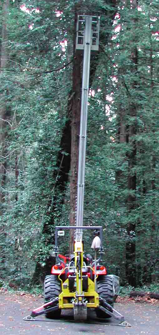

Thanks for all the positive responses.
On the subject of safety, there is no one-size-fits-all. But the
manufacturers are forced to try to achieve that goal. Beyond what the
makers of these lifts include in their products, OSHA even requires that
users must have a non-expired fall harness on them. Of course, OSHA
has no jurisdiction over non-commercial activity like use by the owner at
home.
You bring up an additional safety point, AMPA. Equipment that has not
been cared for eventually can become a safety hazard. With respect to
this project, I was not going to entrust my skinny rear end to a lift
with rusty lift chains, for example. These structural elements are almost
completely hidden from view in the retracted state. My own safety
standards required that it had to be at least fully dissassembled to see
how safe it was.
BTW, I DID wear a hardhat in the video!

That made my sphincter pucker watching that video. The lift tubes if you can call them that don't seem beefy enough for me. Then as you raise beyond each section it seems like your center of gravity would be further out causing a bit of wobble. You are braver than I am. I think I will stick to spurs and a flip line or a regular ladder. That sure would save me time on some jobs if I could get it to the site.

You may want to add a tilt gauge just in case your eye is not off a little. 24' is a lot of leverage. Otherwise it looks good. Still would give me some pucker being up that high. I may have opted for to use two outriggers up front, pucker factor reducer.
Of course I say that when I use my Case BH as a lift. I bought a couple of jet engine work platforms off Govliquidation.com. The hydraulics were shot from being outside but I just locked it at the highest position and use my bucket forks to lift it to what ever height I need. I can get about 14' feet of height out of it and even that high gives me a little pucker.

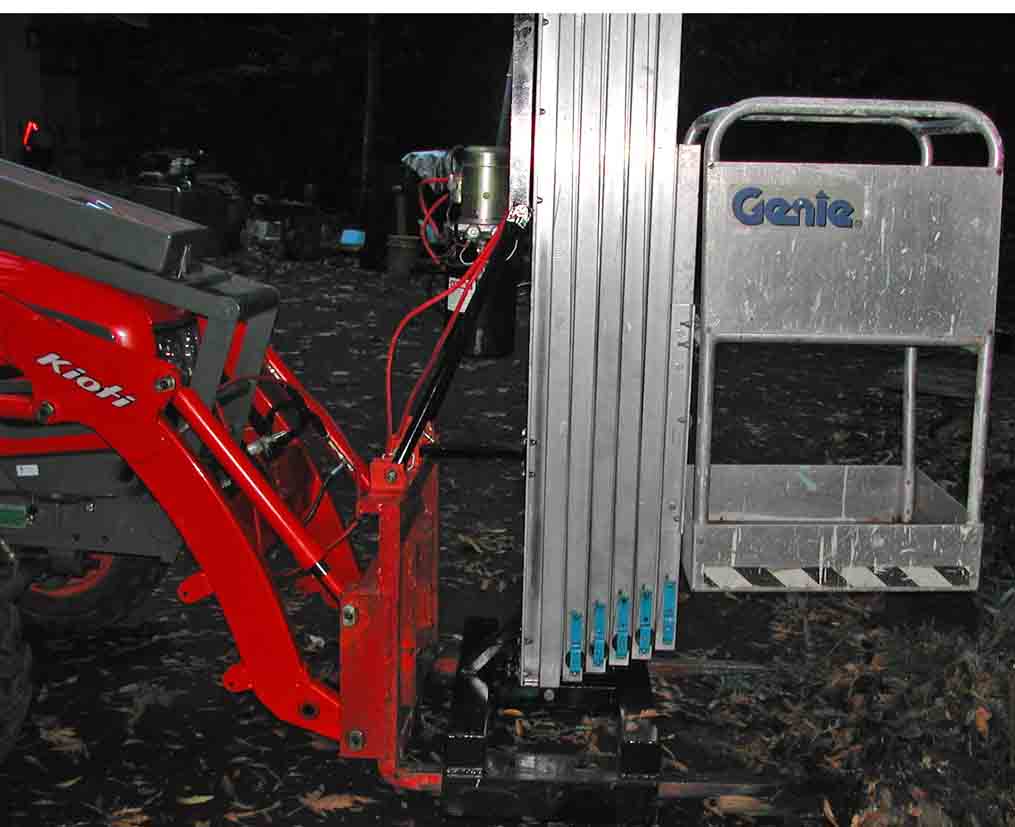

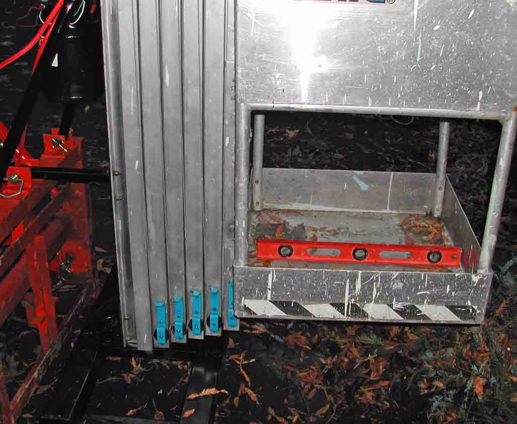

Thats what the orange 2-ft level is for for now (see photo above). The
Genie came with a 2-dimensional bubble level, but I could not salvage it. I
would like to get one, but it won't work better than my temporary level.
I do not just eyeball it for level!
I was just up in a 42' manlift a few days ago (not all the way), and I gotta
say that ALL of these manlifts sway a LOT up at the business end. Not
for the faint of heart, that's for sure. Far more secure than a ladder,
however.
The guy at the rental yard that sells me this stuff was telling me a story:
a manufacturer's rep was demonstrating one of the 36-ft Genie manlifts. He
went up all the way and shook it as hard as he could, without a problem.
It swayed so much, the guys on the ground were more scared than he was!

Just in case anybody was wondering, the formula for the torque applied at the base of his structure is:
Torque = Force * Distance
If the basket is off level by a certain number of degrees, the relation between horizontal force and angle of the tractor is as follows:
horizontal force = weight * tangent(angle from vertical)
For example, if the tractor was 10 degrees off level, the horizontal force would be:
650 lbm * tangent (10 degrees) = 114.6 lbf
Since the force is acting on a lever arm, the torque it applies to the base at full extension is:
114.6 lbf * 24 ft = 2750 ft-lbs.
It is apparent that we had better be careful about using the lift at an angle. The lift parts were not designed with this in mind. I'm not trying to be negative, just realistic. Good luck with your project and be safe!

Awesome! While I don't disagree that there is a degree of danger involved with any device that lifts a person I would be very comfortable with how this is set up. The base is directly under the load and the load is concentric, not offset to the base. I'm sure that is the reason the basket is so small, so it cannot place an eccentric load on the base.
That is why most of these man-lifts that use a straight elevator mechanism to raise the load do not use outriggers. They rely on a heavy base to anchor the load.

I assumed that's was your plan with the rear out riggers on your tractor. I'm assuming Kioti's are the same as other tractors and the front axle has a pivot so they provide little to no side to side support.
You are correct that CUTs have a pivoting front axle and the sideways
stability is due to how well planted the REAR tires are. Unless you
plant the loader firmly down. The hoe outriggers help that too. That is
why I plan to use this at any serious height with the loader forks down
very firmly.
In the test case I posted in the video, I leveled the tractor on unlevel
pavement using the hoe outriggers. I also put some lumber under the
right fork tine so that there was pressure against the ground.
In gaining confidence in this rig's safety, the rope test (pulling on empty
basket when fully UP) is very helpful. Though you can sway the basket
around under this test, you can watch the base very closely to see if
IT moves. It does not.
As you rise in the basket, the cantilever forces between it and the base
increase somewhat, but the increase is in the most stable direction
(forward), and the forks are pressed down onto the surface of the ground.
I once tried out a new Genie scissors lift. The self-propelled kind that
you use only on level pavement, as in warehouses. No outriggers, and
it only went straight up and down. At 30 feet up, I was surprised at
how much the basket swayed. Apparently, these units have so many
pivoting links that all the clearances add up to quite a ride at the top.
Even in new condition. That's a feature, not a bug.
