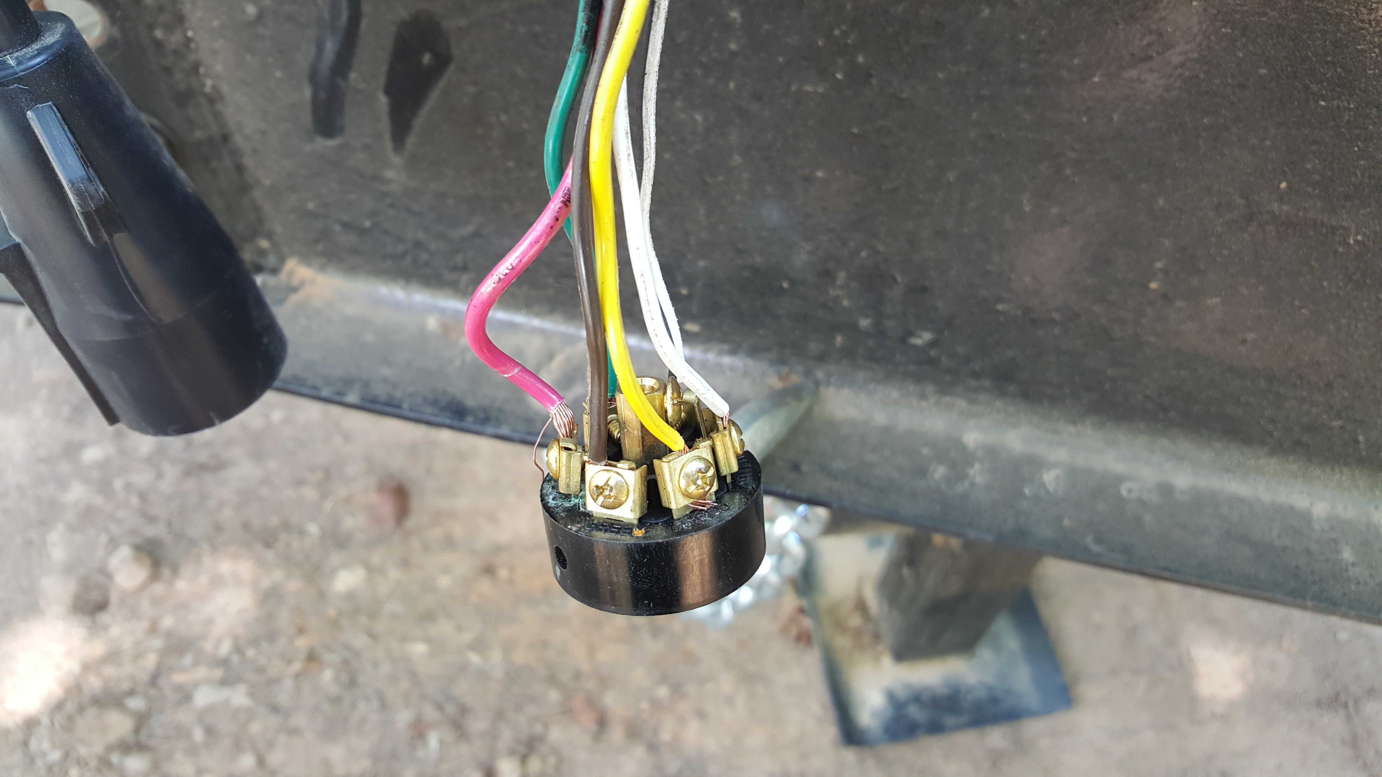

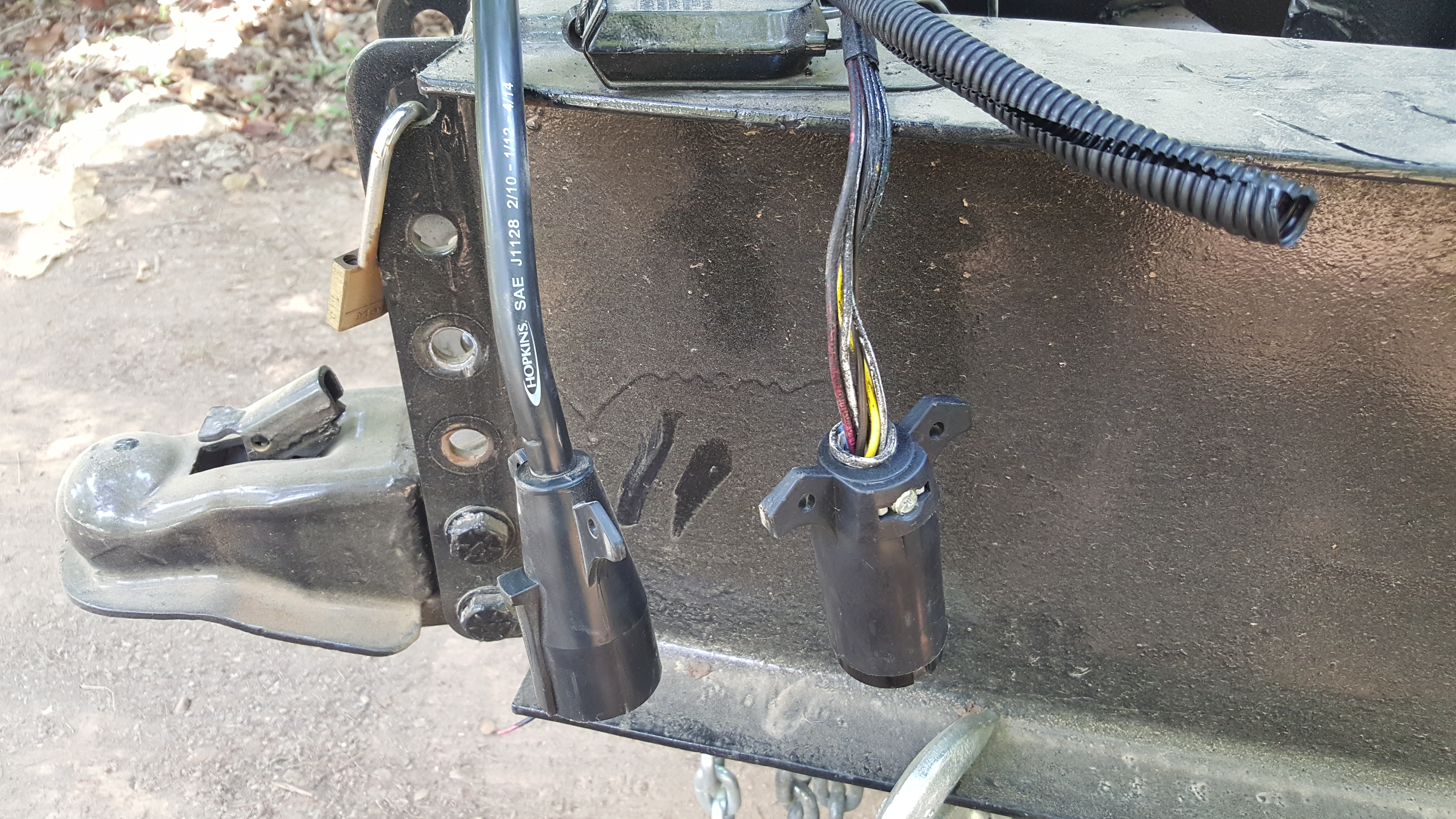

Got a little time today to look at the wiring on the trailer, the plug was wired the same as the brakes were refer to pictures in post 30. I cut the plug off and got the new plug from TSC wired in except for the brakes so with all the lights working properly I am going to start back on the brakes. Running new 12ga wire from the new plug to the brakes, hoping to get that done tomorrow.

and for those that like pictures here is the difference in the plugs. the red wire on the old plug was for the battery and the white/black wire was for the brakes.

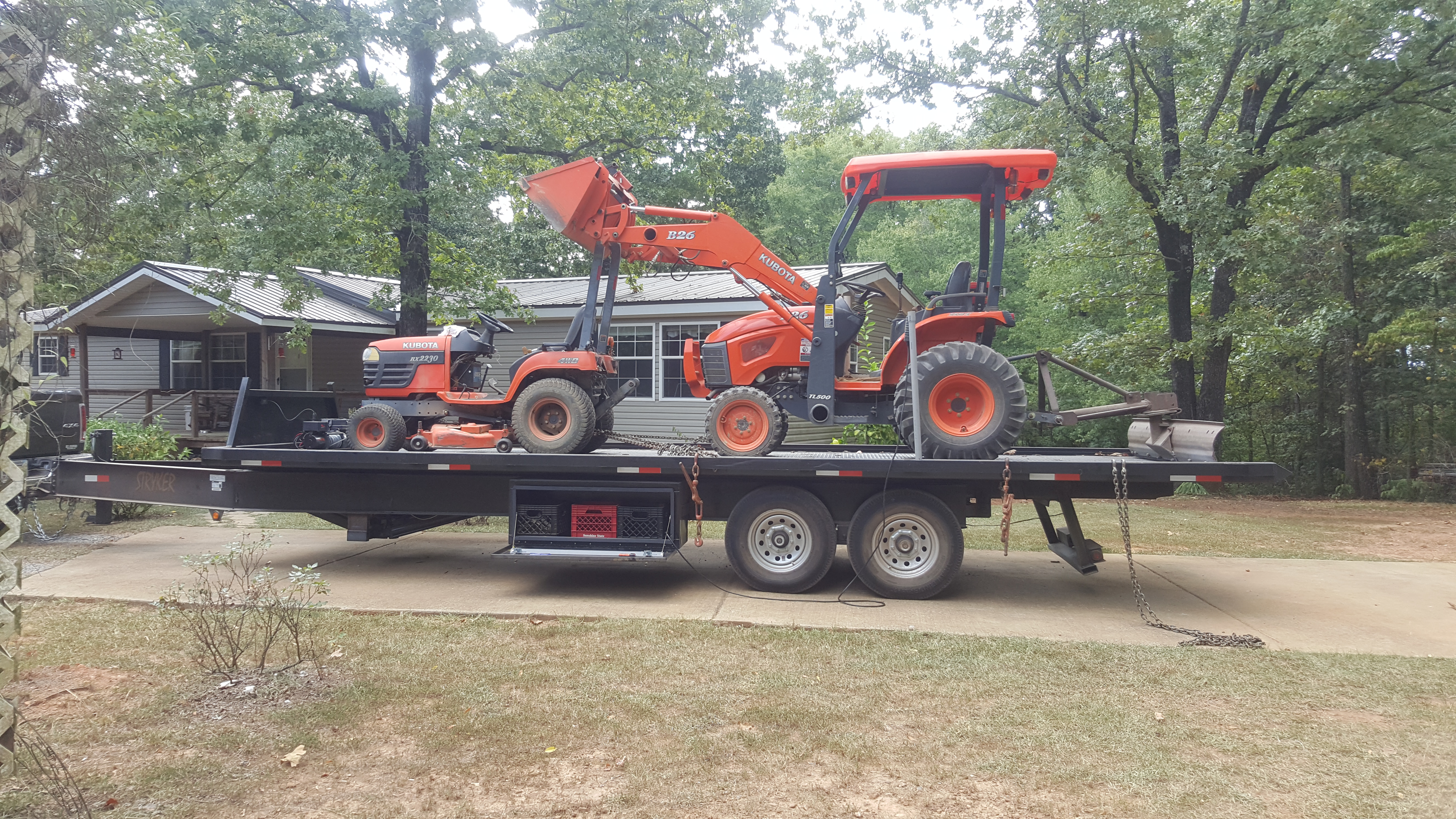

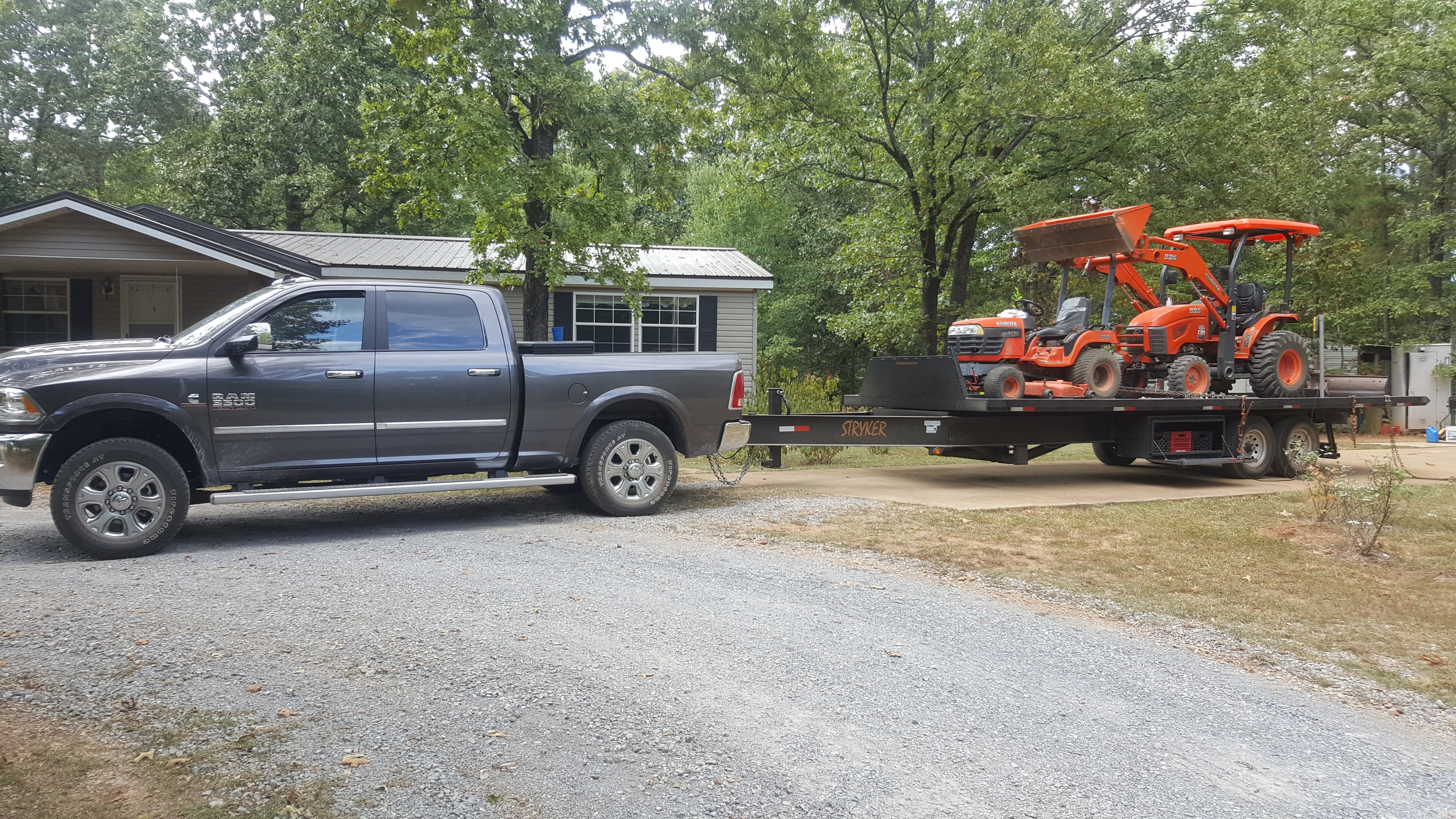

I hope I don't upset the safety police to bad but I need both tractors about 10 miles down the road. No really I wanted to check and see how my trailer does with this load.
and there is the first tractor secured with the winch and a chain, I grabbed the remote and let the trailer down level secured the tractor and raised it back up for the B26. I didn't have the B26 tied down because I was going to unload it and scrape some gravel I was having delivered and when I loaded it back up I did chain it down.

good trip today, with the trailer loaded the way it is in the pictures it pulled good and it did not beat the the truck up like it did before, I hauled three loads of gravel a couple days ago and set my brake controler to 5 as I normally do with the dump trailer then this morning I didn't think to bump it back up for the 24 foot trailer so going down the hill from the house it did not take me long to remember. but even with the load I had on it I settled on 7.5 with the brake controler and I could tell it was helping and also the exhaust brake on this truck is great lots of help slowing down. So all the work I have done to the trailer is paying off.
