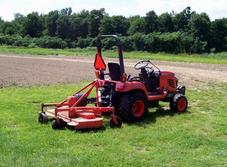

Here is a setup that worked for this tree farmer. The mower is a 54" Woods. I thought I had a better picture of the front weights, but he did have a full compliment of them installed. The mower is a rear discharge since he said that a side discharge mower would spread grass clippings on his Christmas trees, and kill the lower branches.....
