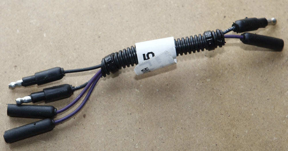

There is, but if you go one click further than where you got the above info you'll see this text:
Forward lighting kit
Note: For 2305 and 3203 Tractor, this kit (LVB25546) is not compatible with Rear Work Light Kit (LVB25547).
You'll quickly realize when pulling information from JD's website, or dealers for that matter, that it often pays to do a little checking before making assumptions as JD makes sweeping statements about entire series of tractors without qualifying those statements (as you found out in the hydraulic foray). The 2305 and AFAIK the 3203 differ from the wiring harness on the 2320 in that they only have a single bullet connector for attachment of accessory lights while most models (including the 2320) have 2 or more. The forward lighting kit includes 2 of the Y connectors I show below, but you'll only use one of them on the 2320 even if you also install the rear work light kit.

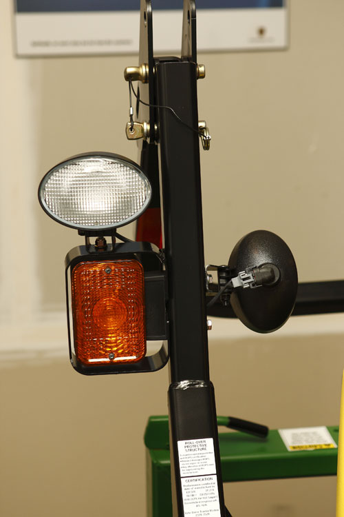

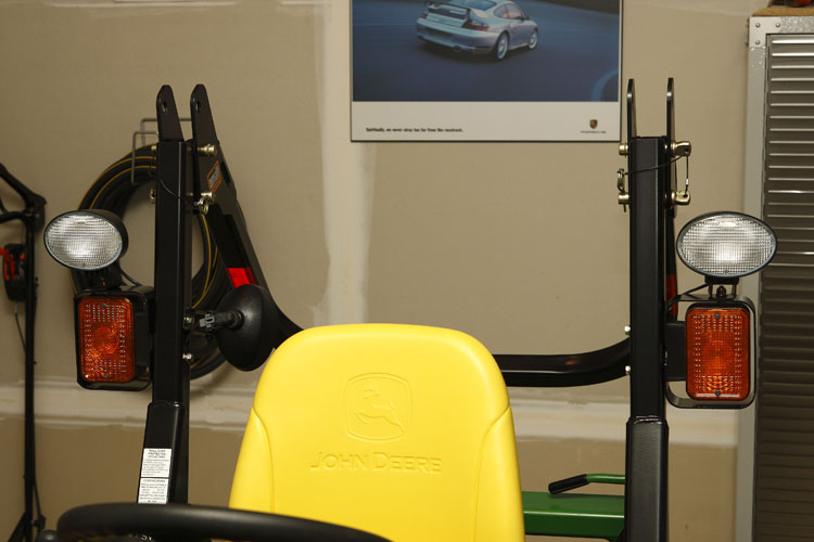

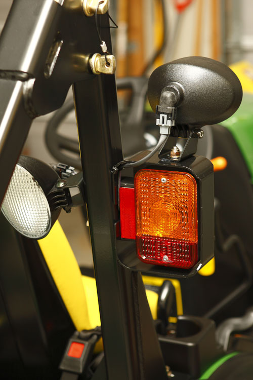

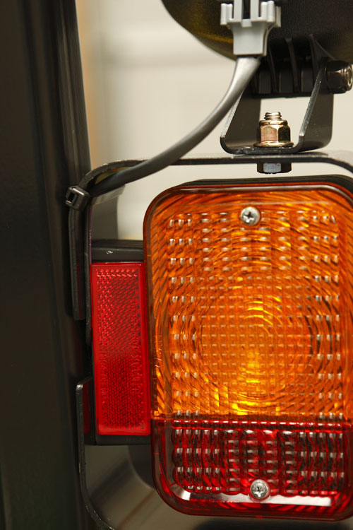

PCABE5 said:
Do you have any pictures of your setup?
I've attached some pics.
In the last shot you can see I ran the wires a little differently than JD suggests. I used the small gap between the ROPS and light housings that mounting the brush guards created to run the wires through the hole on the outside of the ROPS as opposed to snaking tubing around the ROPS to the inside hole. It just looked a little cleaner to me.

I like how you installed these to provide light in both directions but leaving the ability to lower the ROPS without affecting the lights. I know you said that you needed this to get in your garage but I need the same flexibility when mowing around some trees. Good job in triming out the wires to look factory installed.

Good thing I went with the factory light kits because I installed the mower last night in the garage and with the ROPS up the tractor will not go in the garage door. Lowered the ROPS, drove in and installed the 54D in about 8 minutes for the very first time.
Tonight I installed the front light kit and tomorrow I may install the rear work light. The lights look and work great.
