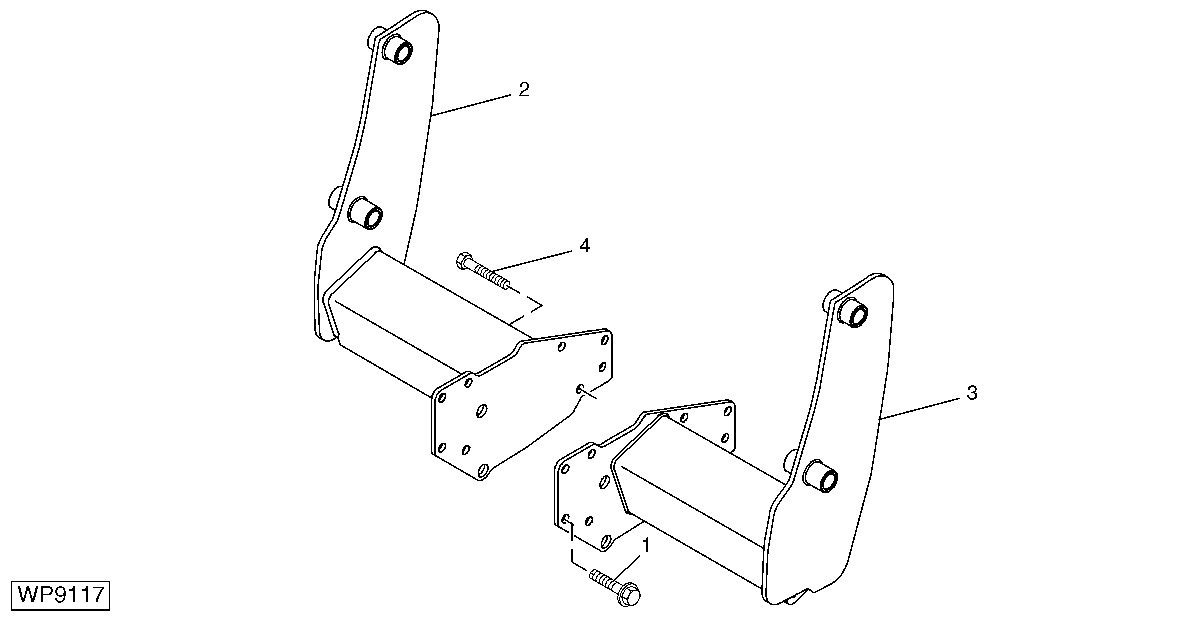

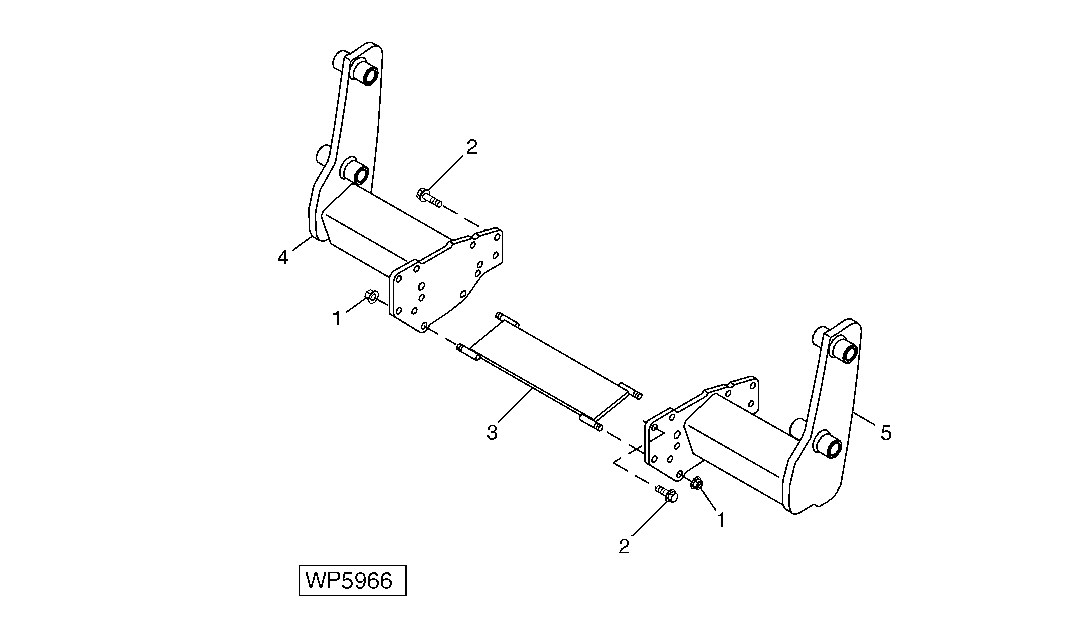

   / 2320 vs 2305 200CX loader frame mounts #4
Thanks guys...
JDparts is your friend:thumbsup:
Here is the 2305 mounts part numbers:
AW33866 FRAME RH
AW33867 FRAME LH
And the first attached picture.
Here is the 2320:
AW33866 FRAME RH
AW33867 FRAME LH
Second attached picture.
So, it appears you are 100% correct. News for me, I though they where different also.
