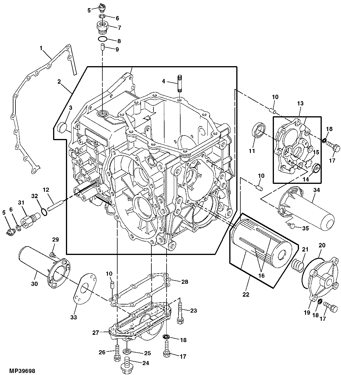

I recently changed my Hydro oil & filter, but could not find the magnets located at the inside transmisson filter, have they quit installing these magnets. :confused:

Attached inside of drain plug inside may have a magnet.
/ 2320 50 Hour Service #3
Mine had the magnets inside the strainer behind the 3pt sway chains.

Hey lipps. Welcome to TBN:)
Jd parts shows the magnets inside the strainer. They are #16. If yours doesn't have them,I would get them pronto.They are a critical part of the transmission filtering system.
Greg
As GLC mentioned, you really do want those magnets. Mine have caught a lot of fine metal pieces that have otherwise gone through the filter screen.
