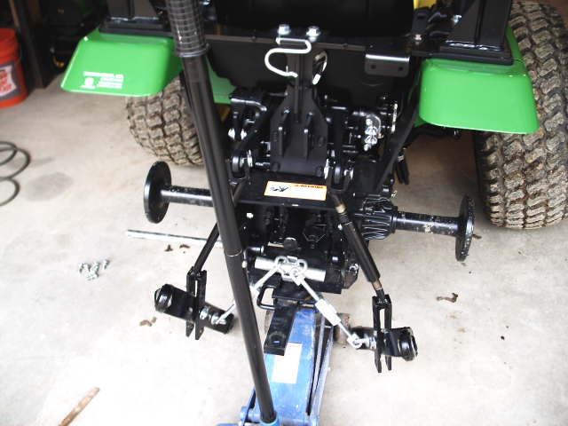

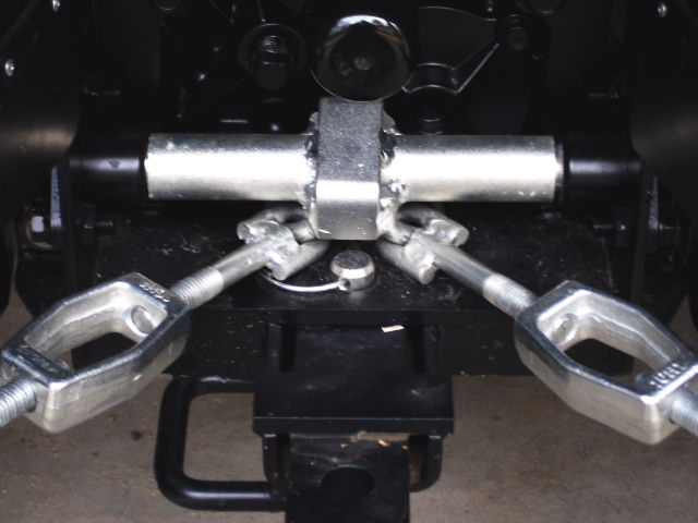

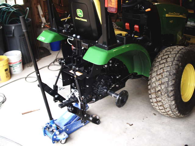

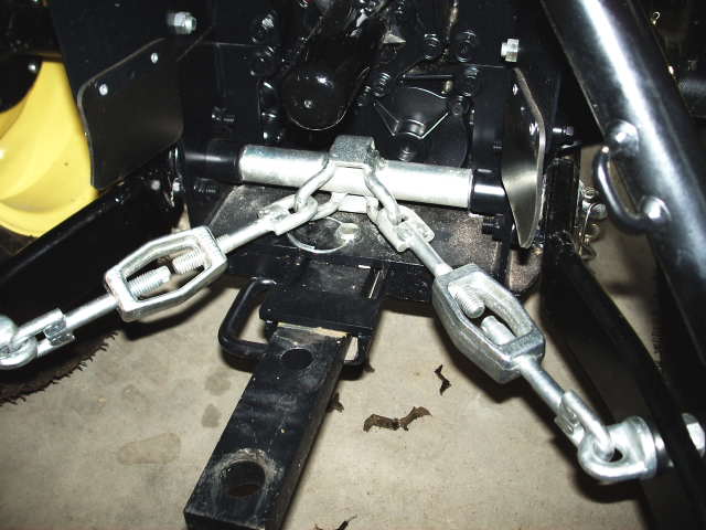

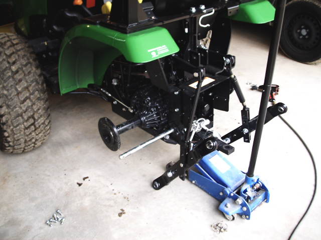

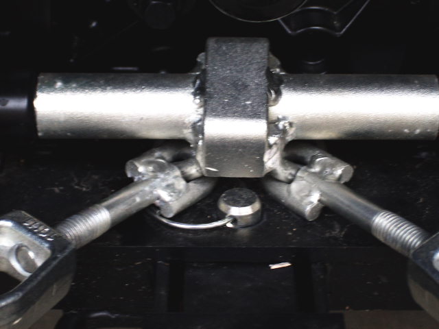

I have been using my 3 point hitch for 2 months now, today I noticed something odd. The links connected to the turn buckes are turned under the shaft. I dont think they are suppose to be like this, the manual shows them in a different orientation. Here are photos.

mine were that way when i bought the tractore so i turned them so they stick out ,but i dont no witch way is right.

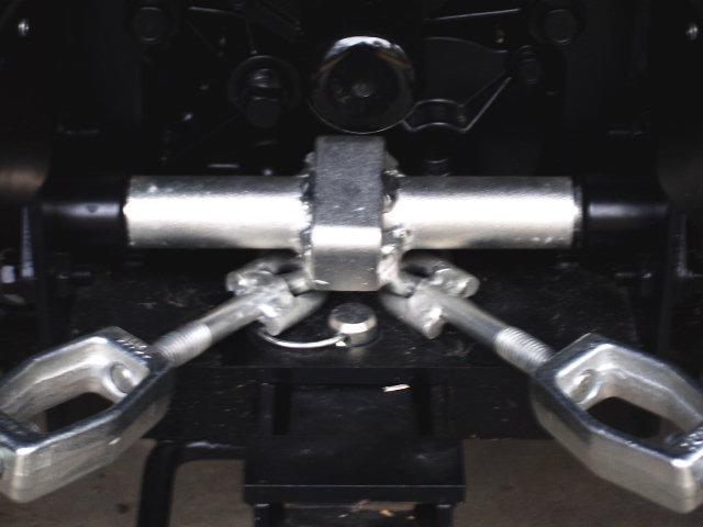

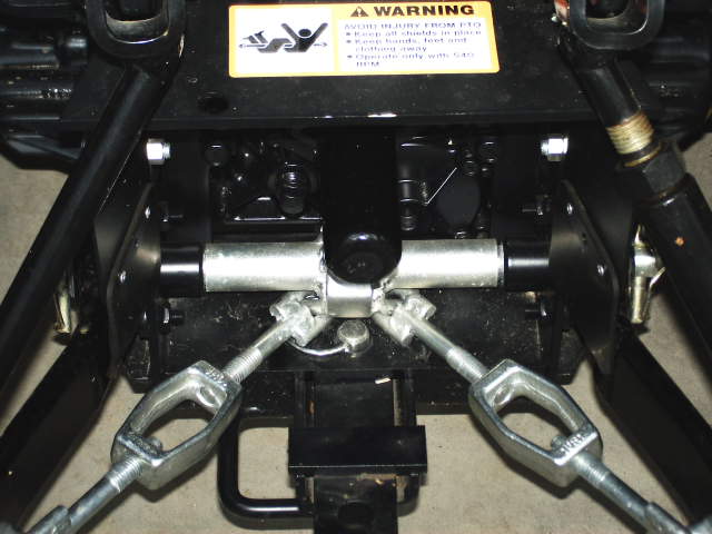

I have it fixed, it wasnt easy, I had to take off both tires to drive out the supporting pin. It was jammed in there from the friction of the links being stuck underneath. I will keep an eye on this as I tighten up the turnbuckles from now on.

when i fixed mine i just unbolted the flanges then there is enough room to move pin i also did this when i changed hydro and cleand screen.

Was your supporting shaft jammed in tight?

Ok I don't want to sound like the safety police....but I will anyways.:)
I had my 2305 supported the same way you have in the picture. I reahed underneath to tighten the trany filter, the Fcunikg thing slipped off the jack and axel caught in the chest on the way down. To this day I don't really know how I got out. I think I kinda of rolled out from underneath. It happen quick.
My wife was around the corner in the yard and heard it fall and saw a tire roll out of the garage(must have leaning on the tractor or something). She though I was 33 years old having a heart attack, I was stuck on the floor with a ghostly white face unable to speak for quite sometime.
Sorry don't forget a secondary methode of support, even if your "not working underneath".........oops the socket rolled underneath.
Remember this: A wise man learns from his mistakes, but a wiser man learns from someone elses' mistake. Please learn from mine!

Effectively your tractor is balancing on two points. The front axle is free pivoting setup so there is zero resistance to stop the tractor rolling left or right and the only thing stopping it from happening is the top of the jack is about 4" wide. One little push and the tractor will tilt until it hits the front axle stops and probably fall off the jack at that point. You are lucky.

Thanks guys for your concerns. I am very safety conscious, I have the 54" plow on the front and lowered. It makes the operation very stable.

Still needs jack stands. Your jack could fail.
I had a friend working under his Kenworth twin screw truck. One axle had both wheels off and he had a bottle jack on each side. One jack failed and he was crushed to death.

Thanks for the advice, I have jack stands, didnt deem them neccessary as I was just pulling the wheels so I could access the 3 point hitch support pin. If the jack failed the rear of the tractor would have dropped and I would have been out of harms way.
