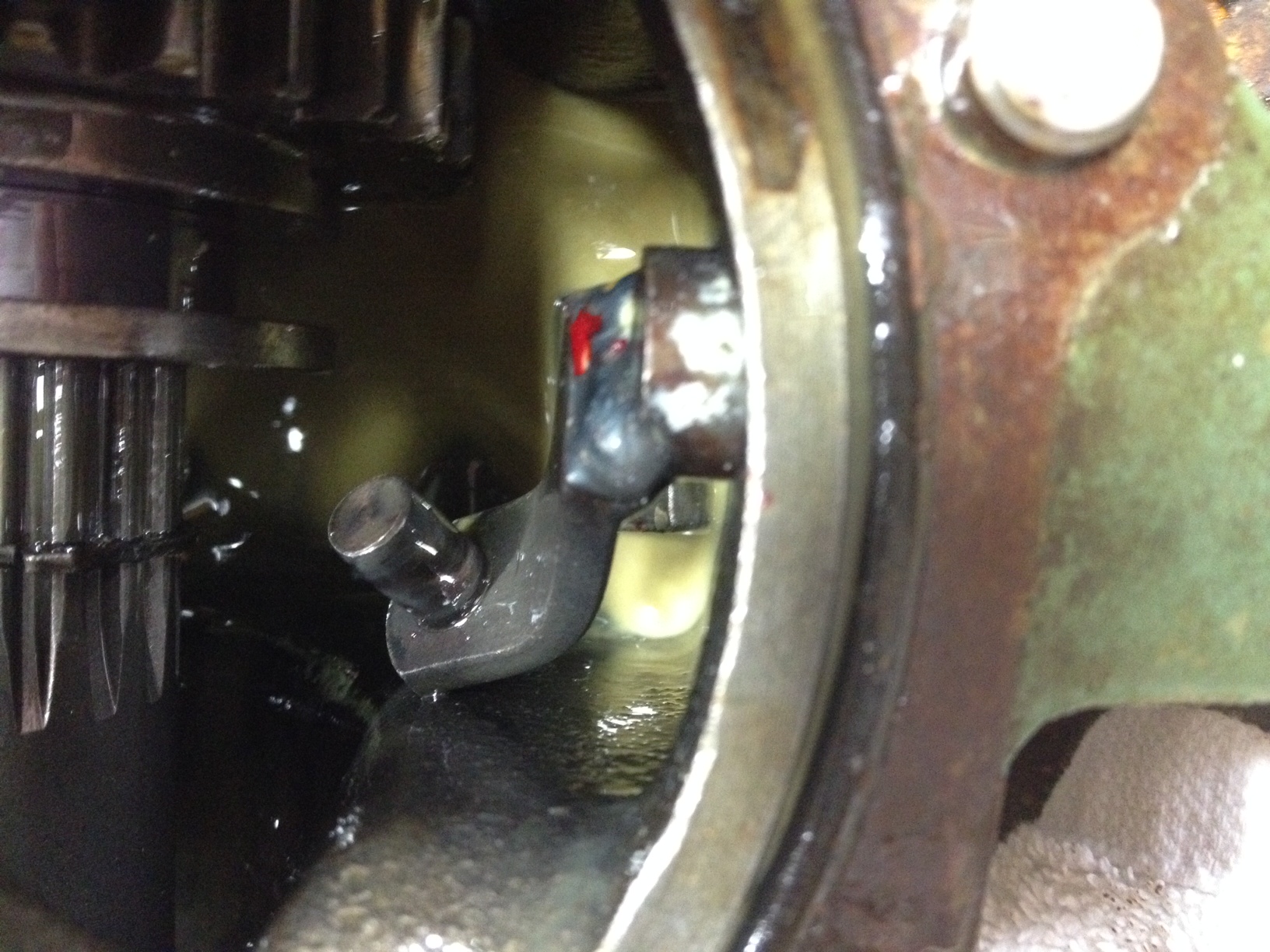

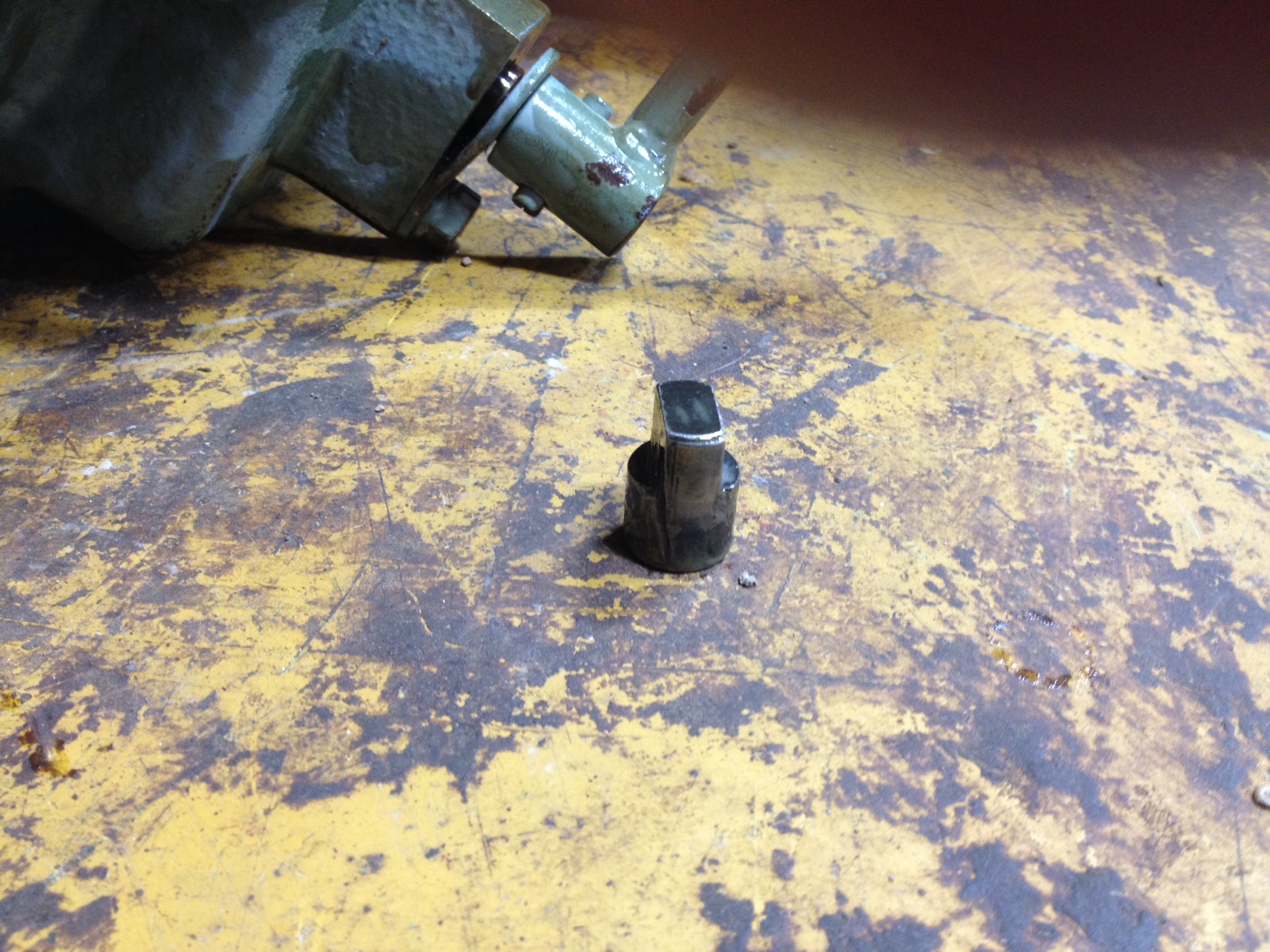

I also drained the transmission so I could take the drop box off to see about the lever. It was locked in 4wd drive as the bottom set of gears was pushed back and engaged. Not sure how this box is supposed to operate but it looks to me like when the lever is pushed forward (put in 4wd) it should push the bottom gear back to engage it. I have attached 2 pictures. The small piece fell out when I took the drop box off, I am assuming that the flat part fits in the groove of at the front of the bottom gear and the round part fits on the piece welded onto the lever. This would make the gear move back and forth with the lever....but not positive about that.
The piece of basically flat stock that is welded to the lever handle....should it be straight? If it was, it seems like the 2 pieces would fit right together and be able to move the gear. The piece of flat stock, as you can see in the picture is bent quite a bit. How to proceed from here?? Any suggestions yet.

   / 2310d 4wd problem
Thanks Winston.... there is a pin that holds the lever part together. Can I just drive that pin out to get the lever piece by itself to flatten it out? If so, is it reusable by simply driving it back in?
Thanks,
Gonna try and put it together tonight or tomorrow.
   / 2310d 4wd problem #6
I believe that is a 6mm x 25mm spring roll pin that holds the shift lever on. Yes you should be able to drive it out and them re use it. Just wondering if that piece is going to straighten out without breaking. I have to believe it must not be heat treated or it wouldn't have bent without breaking to start with. Someone with more knowledge than me might tell us if they think heating it before straightening might be a good idea. My inclination would be to heat it before bending. Just my 2 cents, doesn't make it correct. But if you don't have access to a torch it might not matter.
