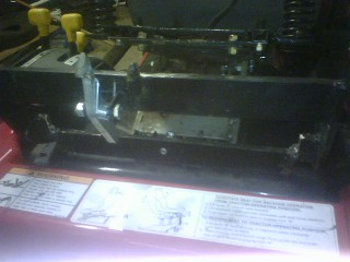

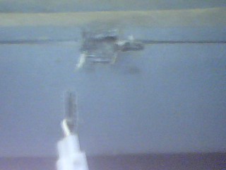

I tried the mod to my seat today what a difference. If you have the seat in the last 2 slots on the adjustment look at the bottom of the seat you may see a worn spot where the latch holds the seat down. I removed the latch and moved the bar down 3/4 inch now the seat moves instead of setting on the latch. After being beatup for the last 168 hrs it feels like a new seat. The only problem I have found is when I put it on the back of my pickup FEL loader to the rear the seat blows over on the steering wheel at 55MPH.

Here is a pic of the seat bottom where it rested against the latch.
Here where I lowered the cross bar. The stop for the seat when it is turned for the BH still works.
I also fixed the latch that holds the seat in the BH position. The backside of the latch hits crossbar and keeps the latch from fully engaging. I have had the seat fall back when I was setting on it.
