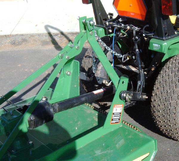

/ 2305 with LX4 #6
Here it is with the chain. I found some snap links at TSC that I use at the ends of the chain or one at end and the other at the link in the chain that gives me the length I want. One end of the snap link is just the right size for the top link pin to go through it and fit nicely. I can actually have both the top link (with end on the LX4 attached and flopped back) and the chain in place for quick changeout. Right now, I'm using the top link with the chain to the side on the pin at the top link end of the LX4.
The chain allows the LX4 to follow very severe changes in terrain but does have 2 disadvantages: 1) can't raise and then lower onto some brush; 2) usually you want the chain to not allow it to drop down a very steep slope, like a creek back, but the chain then keeps you FROM dropping it to mow a little bit lower just below the top of the bank. The LX4 will not raise very high on my 4010 with the trail wheel properly adjusted though. So, the #1 disadvantage isn't that severe.
A severe change in terrain, like a big dip, can cause both rear wheels to go off the ground or possibly bend the links if using the solid top link.
The LX4 properly adjusted does allow quite a lot of movement of the "hog". The chain allows a bit more though.
Ralph
