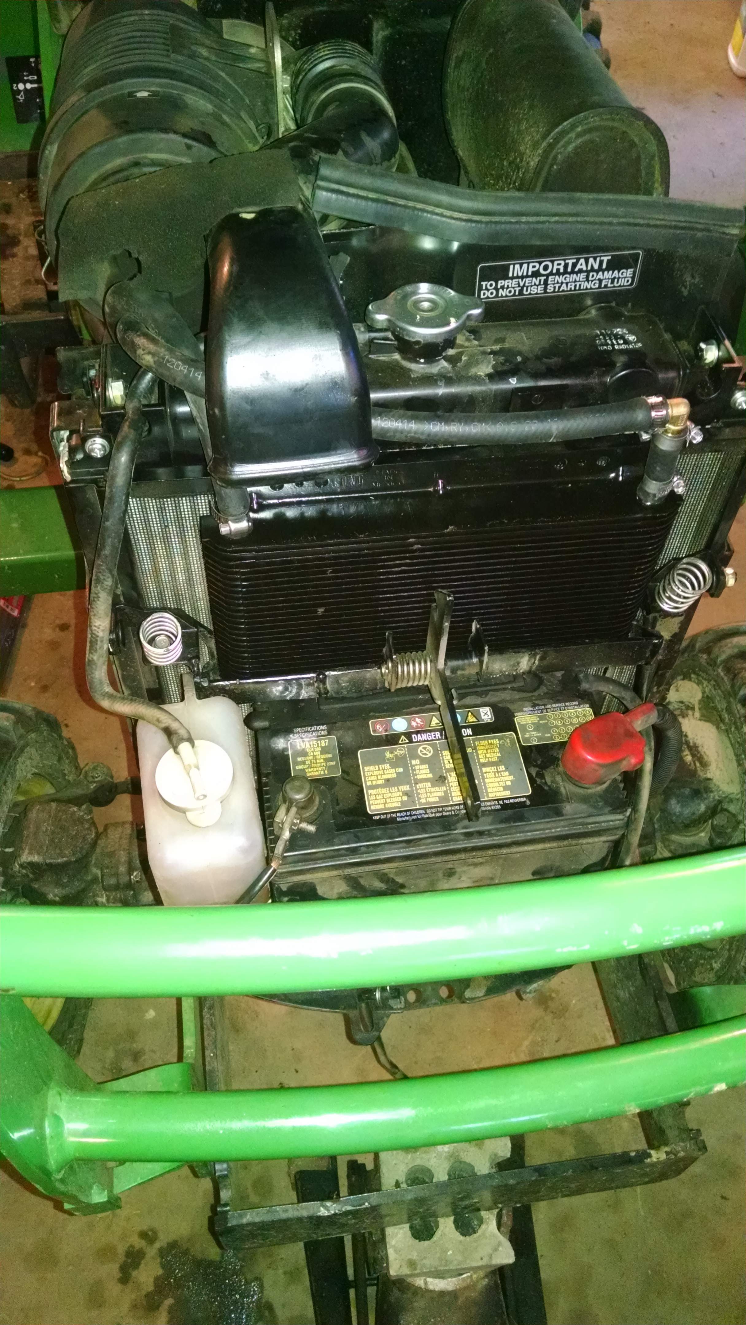

Hello I've been reading this site for a couple years and want to contribute a few of my projects...I have a JD 2305 and I finally added a transmission cooler after 600 hours. I've never seen it done only discussed and I thought I'd share with anyone interested.

And I have pictures. This is my first post and I'm not sure how to add them...

I hope your cooler install included flared fittings on the lines and not just hose clamps. The hydraulic system and transmission lines have high pressure that would and hose clamps would probably not hold.

Yes flare fittings...and it's not on the high pressure side it is tied in on the return going into the fi IMG_20150923_163200938.jpglter.
