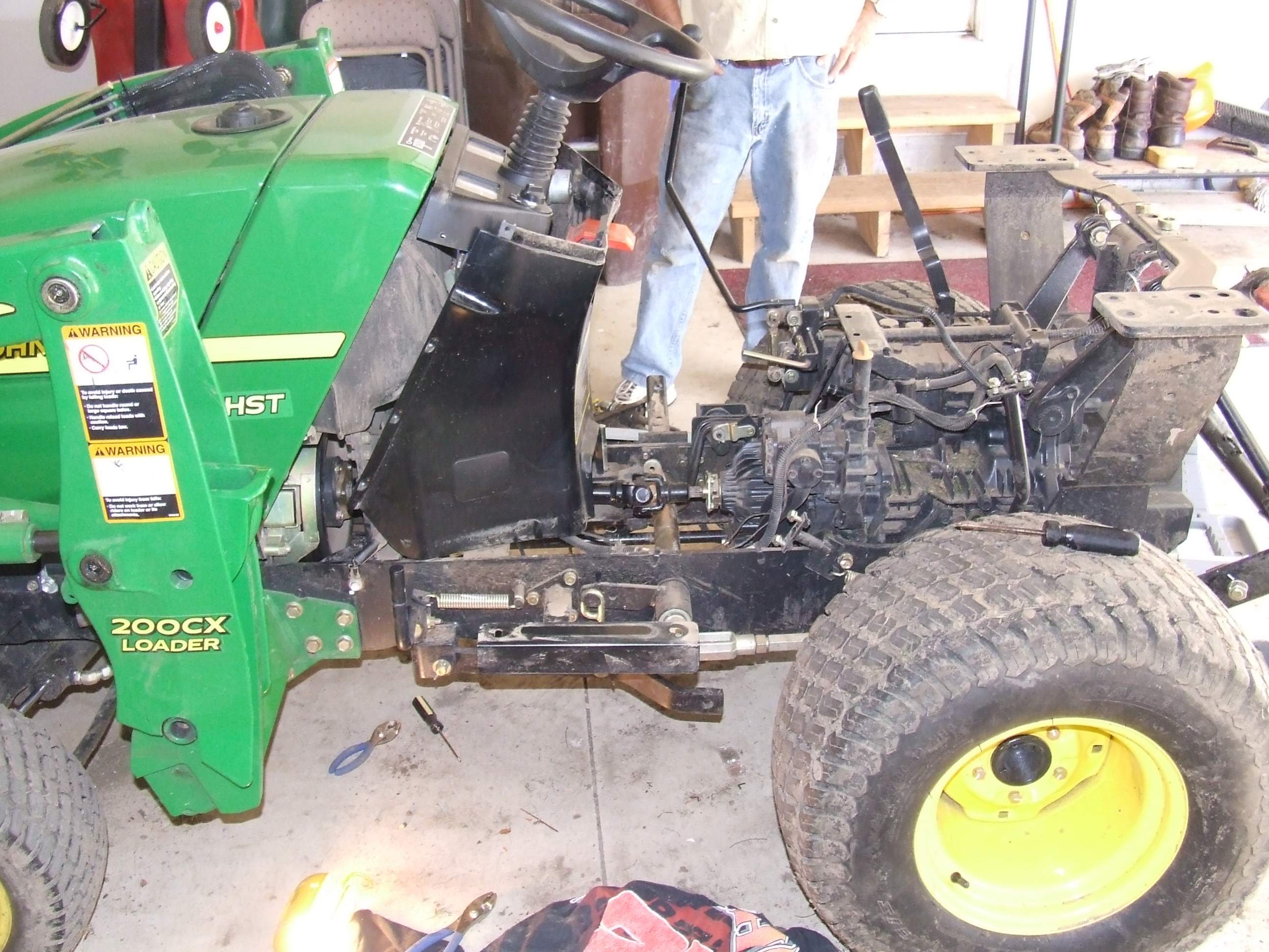

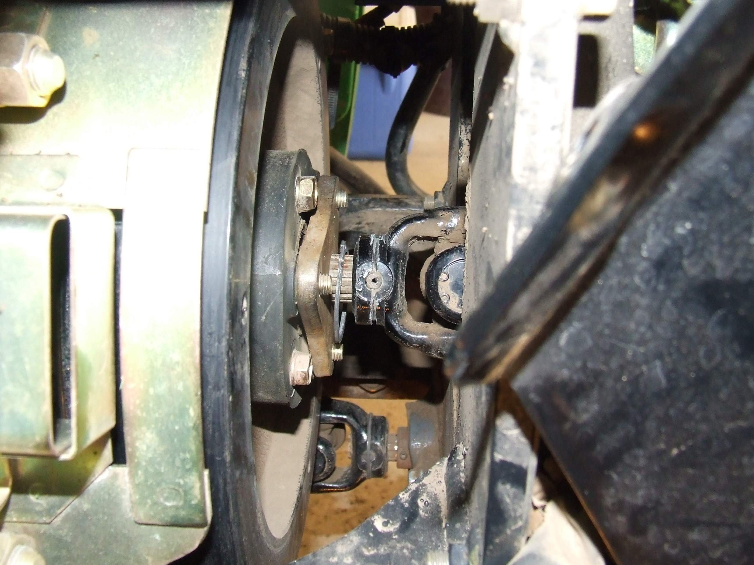

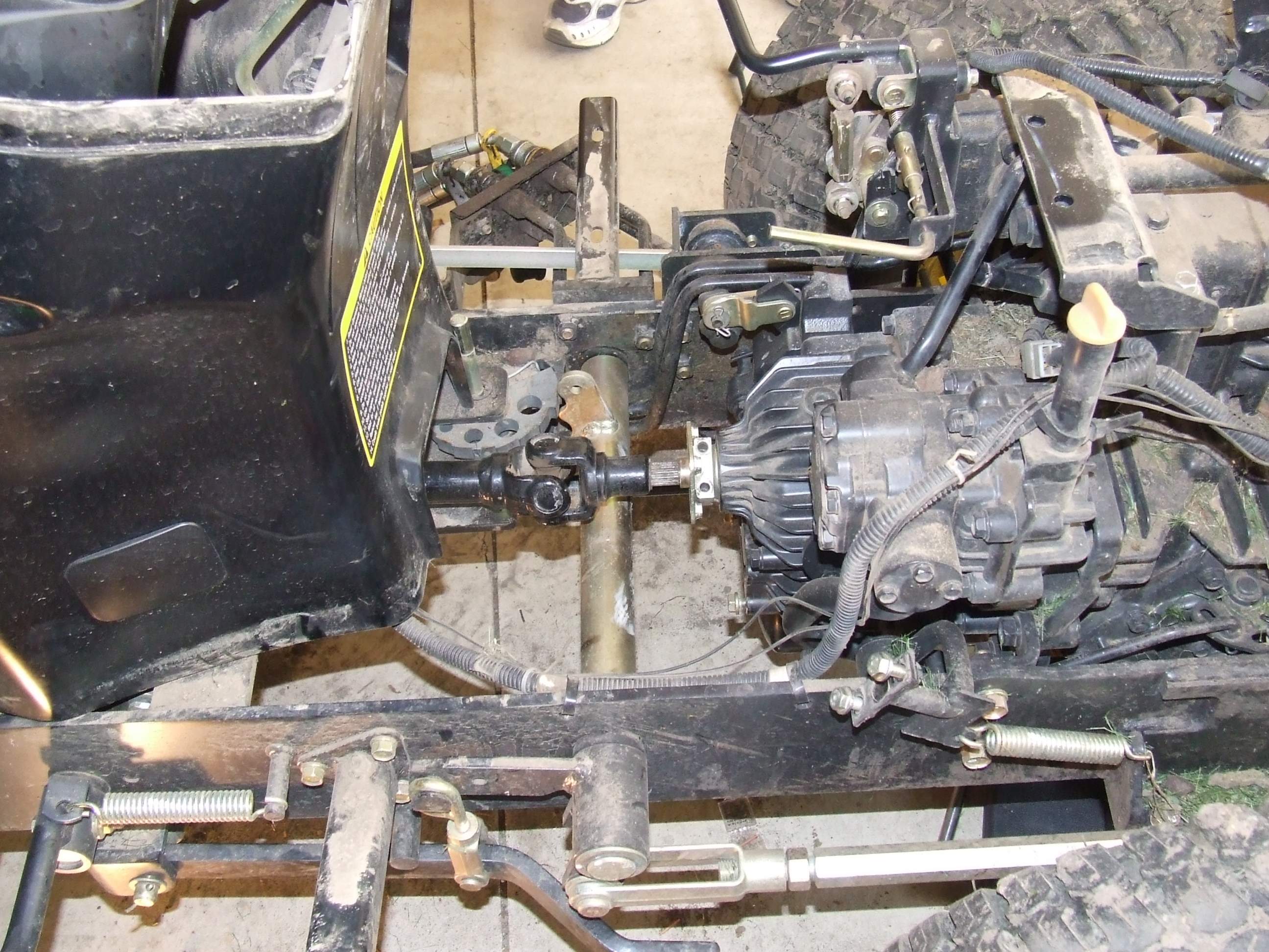

All fixed about 6hr job but I have some new ideas if it happens again. Not sure I needed to take all the finders apart and floor but I did and it did make it easyer but I think I might be able to just get the front pin of the driveshaft out with a little help from someone. I do have some pics if anyone is interested. Just a few of it apart I forgot to take one I replace the fan LOL.

I hope this works
/ 2305 Trans fan gone #13
How did you remove the driveshaft? did you remove the roll pins,flange or something else?

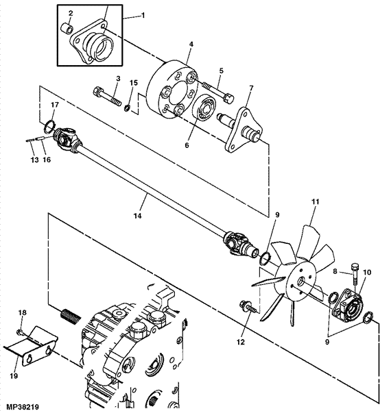

I don't know how to link back to an old thread, so I pasted 2 posts from an old thread here (see below). This is how I got my fan repaired. I took these posts, and a diagram of the 2305 driveshaft which I downloaded, to my dealer. He used this approach, and had my fan replaced the next day. You don't have to disassemble anything except the rear universal joint in the driveshaft. Hope this helps.

here's a diagram of the 2305 driveshaft

I am here. :) You need to get to the front pin of the drive shaft. Take off the clip then drive it out. That should allow you to push the shaft back far enough. That is the hardest part in my oppinion and getting the clip back on is a little tuff too.
