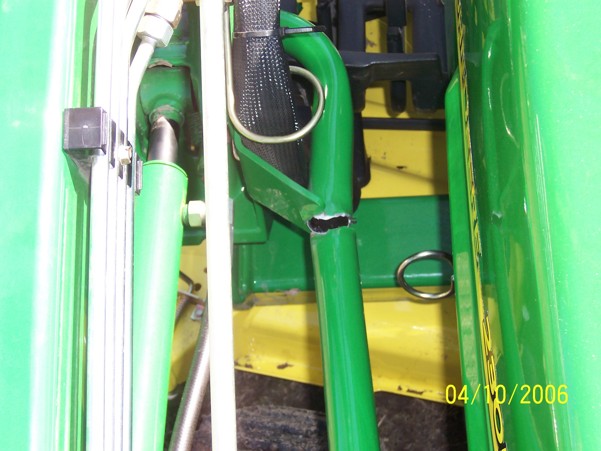

Okay, it was bound to happen as I've bent the stand for my 200CX loader a couple of times. This time, it snapped off while bending it back down. Anyone happen to have the part number for the stand as I'm unable to find it on the JD website. And, I'm guessing that JD is probably the only place where I'm going to find a new one ($$$ on my mind). If anyone else has replaced this already, how difficult is the work? Thanks in advance.

Here's the part number, not cheap,,
i've seen a couple get bent up.
AW33086 STAND
they list for around $230.

I shared my similar story with TBN. Bent mine in the first month, it broke when I tried to straighten it. Dealer did the repair, $210 parts, $60 labor, free pick-up and return. (4/13/06)
Lesson learned:
Remove loader on FIRM, LEVEL ground.

Can someone explain how this happened? Is it because it was being removed/installed on uneven ground??
/ 2305 FEL stand
Thanks for the part number.
I only have enough room in my garage for the tractor, so the FEL stays outside. After the first snow when I went to install the FEL to plow, the stand had sunk into the mud, then froze. So the first time I bent it was that day putting it on. Got it straightened out, but could tell that the bent point was weak. I was careful to then always keep the FEL on a piece of plywood. This time, however, was on uneven ground when only one bottom side had lined up and I began to curl the loader to set the top. It just went from bad to worse after that. Anyway, the stand isn't that strong and I believe that it's length, when not careful, is a good way to blow $230.

Forgot to ask.... Dutch: I'm not a farmer, so not many tools or experience with tractors. Is this stand replacement something that I could handle myself? It looks as if I only have to remove the nut from each side, and not take the bolt/pin from the loader. Thanks.
