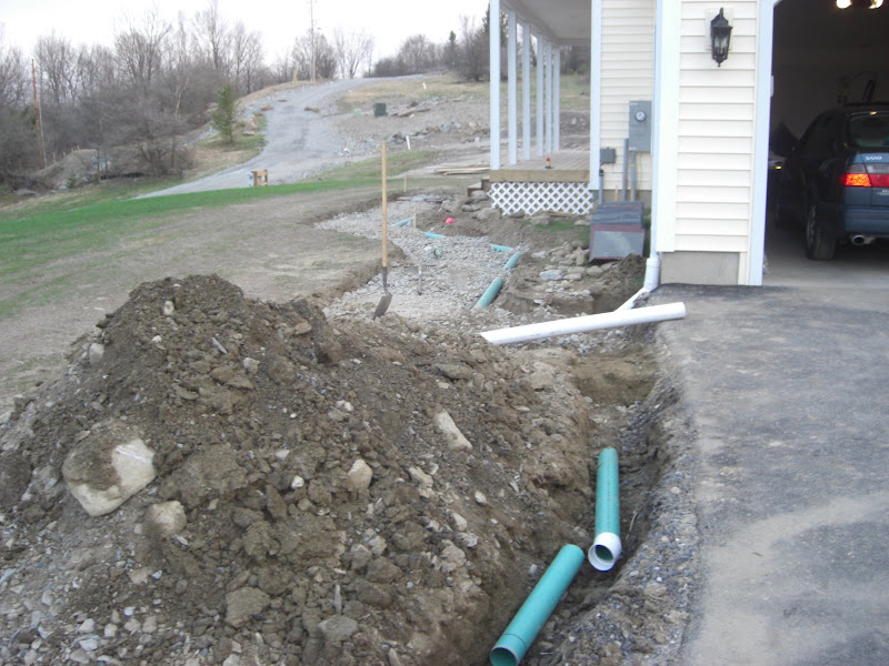

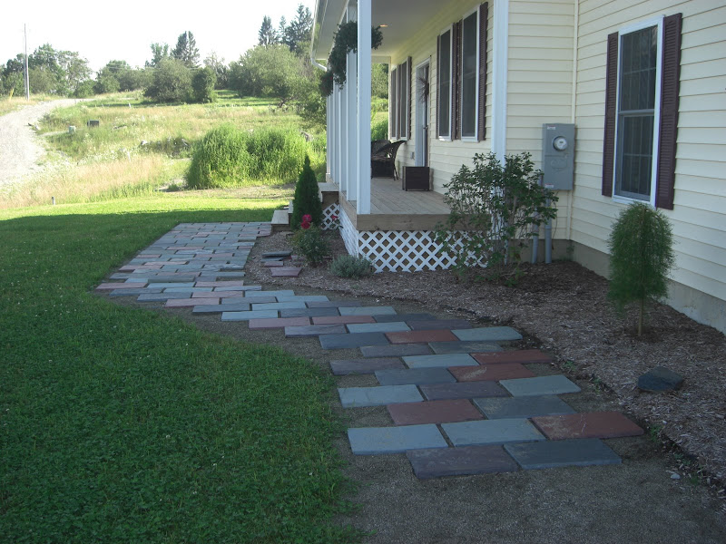

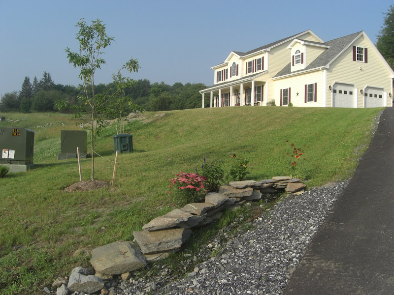

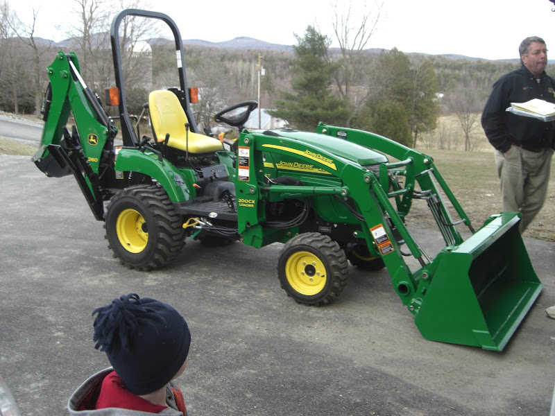

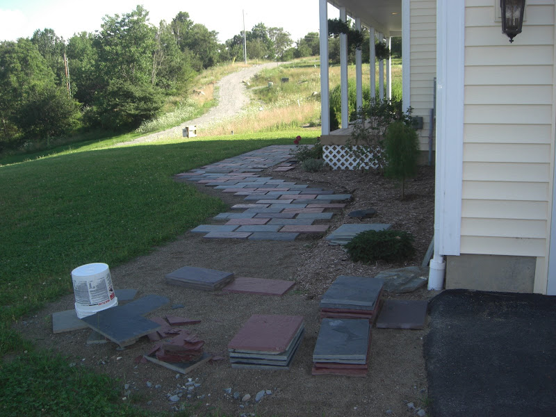

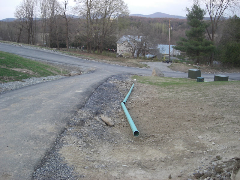

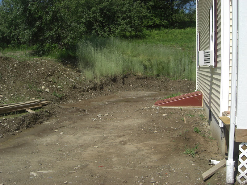

I was on the same boat 4 months ago when I bought a 2305/200CX/260, I only have 0.8 acre but have a TON of landscaping, drainage and other work to do. I do my mowing with one of my 2x 214's and have put 50hrs on my 2305 since April. To date I have moved or dug:
40+ yds of clay fill
30+ yds of screened topsoil
30+ yds of crusher run
600sq ft of slate walkway dug and filled with 10" of crusher run and 3" of sand
Installed well over 200' of 4" solid and perf'd SDR35 covered in crusher and buried under topsoil
I would not of been able to get into 1/4 of the places I needed to be if I had a larger frame tractor. As mentioned before, know its limits, take your time, BE SAFE and enjoy the view...
