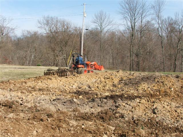

I have a 14" single moleboard that works really well behind my BX 2200 and I can pull it 6" deep and more with no problem in 4wd, although I have loaded ag tires. Will post a couple of pics.

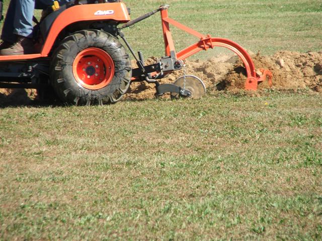

That's a B Allis Chalmers plow that I cut down and made a Cat1 three point hitch. Here the ground was really dry and hard, have used it later in better conditions and have been really pleased. I think yours will pull a plow if you have the weight and Ag tires or chains for Turfs if that is what you have.
