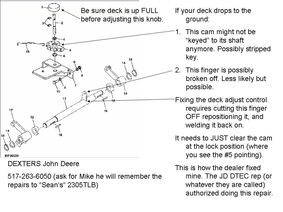

First, my deck height adjustment knob does not work. No matter what height setting I put it on, when lowered it is stopped only by the gage wheels. Second, when I raise my deck, it "leaks" back down to the gage wheels in less than thirty seconds. The only way I can "transport" is to continually bump the "joy stick". Like I said previously, both times the repair lasted only a short time.
I am glad your 2305 works as it should, I just wish mine did. Maybe my third trip to the dealer will be the one that fixes it. Right now though I regret buying it.

I have a 2007 2305 with a 62'' mm deck, this year i had the independent lift kit installed. I HAD THE SAME PROBLEMS YOUR HAVING. After my third trip back to the dealer finally the problem was fixed. First the setting decal was set wrong and the internal stop for the height adjustment was not catching to stop the deck. A new decal was installed and new part put in for the stop however the indepent lift kit is designed to raise and lower the deck only not hold it.Your deck needs to be set at the height you want and the the height adjustment knob stops the deck. The only thing i'm unhappy with is the fine adjustments aren't there. Its either high or low nothing in between to speak of. I hope this helps, its still a dam good tractor.

I appreciate the information. I guess everyone has different needs/expectations in a tractor. For me the 2305 has not lived up to my expectations and if I had known the limitations of the MMM, I would not have bought it. I don't want to have to lock my deck out to keep it from dropping down all the time as I transport over rough ground, sticks and such and also use it to pull trailers and such. I also miss the fine adjustment feature. Yes, it is a "**** fine tractor" just not for me. I have been trailering my other tractor up there when I know I am going to need a small tractor. Fortunately, most of the time someone else uses it.
