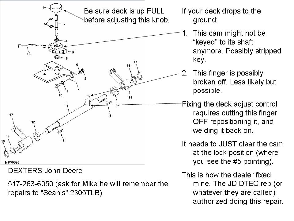

First, my deck height adjustment knob does not work. No matter what height setting I put it on, when lowered it is stopped only by the gage wheels. Second, when I raise my deck, it "leaks" back down to the gage wheels in less than thirty seconds. The only way I can "transport" is to continually bump the "joy stick". Like I said previously, both times the repair lasted only a short time.
I am glad your 2305 works as it should, I just wish mine did. Maybe my third trip to the dealer will be the one that fixes it. Right now though I regret buying it.
3 trips to a dealer for this is wrong on so many levels... It's good that it's you and not me because I handle situations like you are finding yourself in very poorly. I have a way short fuse for such things.
Regardless, I have attached a picture you should be able to take with you to your dealer (possibly a different dealer). The picture has the contact information for the service guy I deal with at my dealer. He has provided me top shelf support. I am sure he can communicate to your dealer what they did with my tractor to make it work right. He can also probably get your dealer in touch with the JD "rep guy" that approved all the stuff (including this deck alteration) to my tractor.
I understand you have a BROKEN tractor. What I can't understand is the folks that complain about leakdown when they have a WORKING adjustment knob. Please don't feel I was calling you out in any way. If you felt that was the direction of my post please accept this information as an olive branch.

No offense taken. Thanks for the information, I will print it off and take the machine up myself as to this point I have delegated this to someone else as I won't always be around; preparing future generations. My age and health keep me from doing all I want or use to do.
Believe me, I know what you mean. The people who normally use this machine told me it was working fine. I was checking on another tractor that had gone toes up on that farm and hopped on the 2305 to move some stuff and mow a path for the Service Truck and discovered what "fine" meant.
I am curious as to why the hydraulic system would not hold the deck up for transport just like it does a FEL. Maybe I am missing something as this is the first system I have seen like this.
