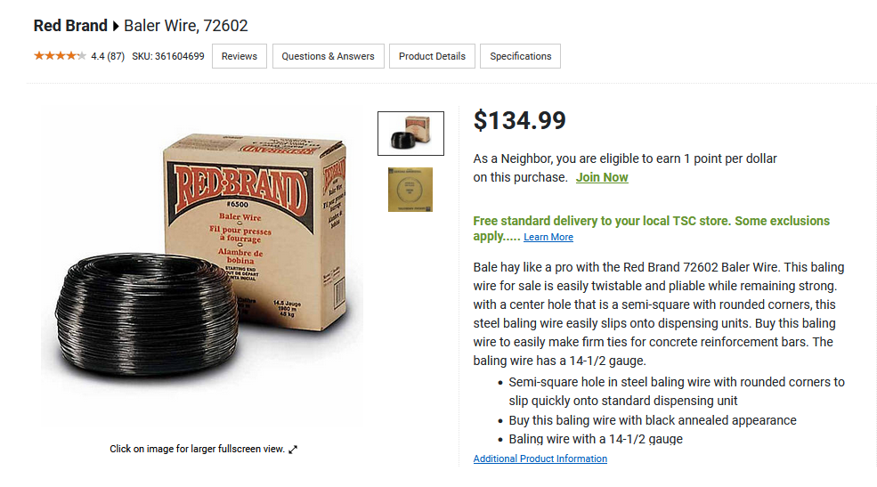

And by any chance would you know the wire size that John Deere recommends for the baler?
/ 224ws square baler #4
Baling wire for small sq balers built since the mid 1950's used baling wire that comes coiled in a cardboard box & it's 14-1/2 gauge in diameter. Several different brands are sold at Farm Supply business's & equipment dealers. One brand is shown in photo below.
Have you checked baler wire guides & rollers for grooves or stuck rollers? Baling wire isn't coated with as much oil as it was 40 or 50 yrs ago so back when I had a small JD sq baler after wire is installed in baler I always opened top of cardboard box & poured oil on the wire in the baler.
My small sq baler expertise is with JD sq balers. So if you have any questions feel free to ask me & I'll try to assist you. I suggest you get an extra bronze shear pin(E19994) item 3 in link below.
