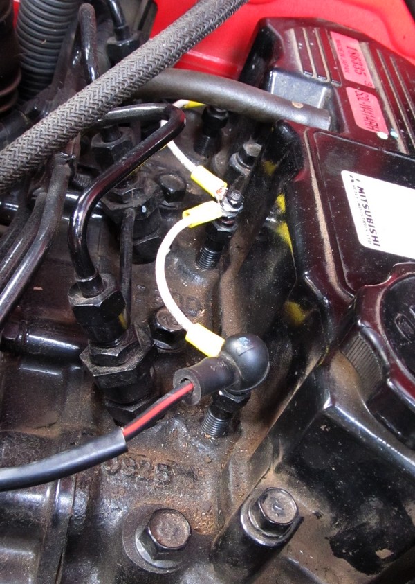

Where are the glow plugs located on my 2216?
/ 2216 glow plugs #2
Should look something like this I would think..
/ 2216 glow plugs #3
That image may be one I posted a while back of my 2216. Originally there were metal straps between the glow plugs which I didn't think were making a good connection due to corrosion where they were nutted down.
/ 2216 glow plugs #4
Interesting Just one I took off google, should be similar to what he is looking for and I agree, I have the metal thingy I didn't like the looks of and replaced it with what you did.
