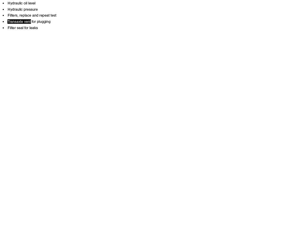

I appreciate your post. The JD service manual (pages 263 & 264) mentions the transaxle vent but I cannot find it's location documented.
Screenshot attached.

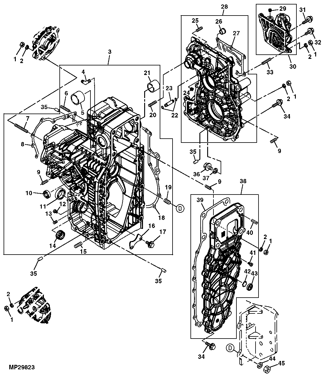

the vent is located on the top left side of the transaxle. I am trying to attach the parts explosion for this, the vent is number 4

Greg, it appears that Gary has found it - good job Gary. However, and for your information, in the 2210 technical manual diagram that I have, in comparison to the diagram that Gary has, it is called a "Breather Pipe", not a transaxle vent. I don't know the reason for this but the part is identical and in the same location on both diagrams.
I tried to locate it on my 2210, but it is obviously tucked away quite nicely and I was not able to find it.
Chuck
/ 2210 Transaxle Vent Location #6
from the appearance of the pipe, it looks like a hose may be connected to it and extends upward, probably under the seat where it would be away from water etc.

Excellent. It's a "breather...pipe...vent". Thanks again to all and their efforts.
