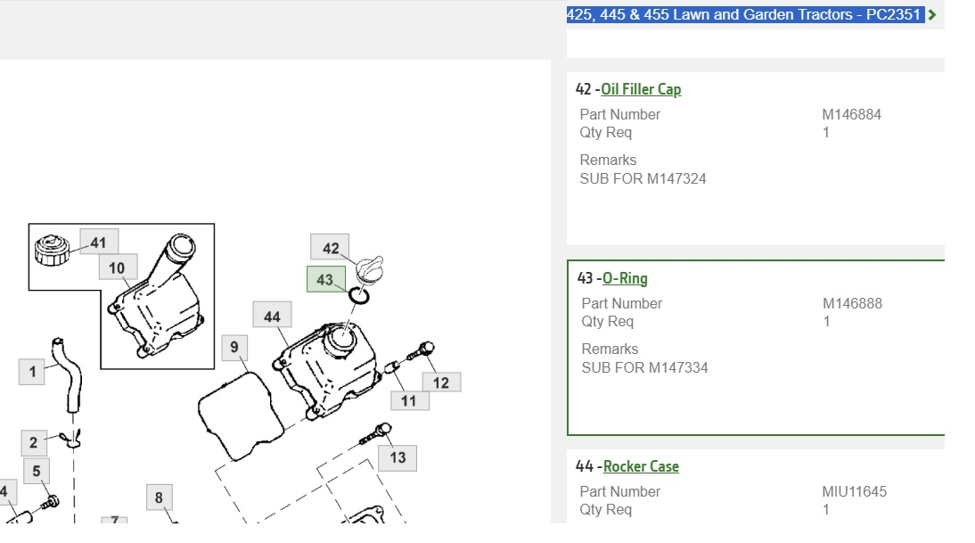

Will M146888 F/R shaft transaxle seal work on a 455? A video says it will work on 445 & 455 but another video says that CH17653 is the correct seal for a 455.

Deere had a great parts break down website. I would suggest searching that site by your model and or serial number.

If I read it right, the CH17653 part number goes with the two packing seals key #18
