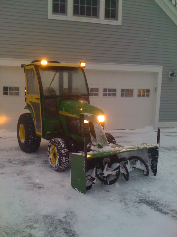

I too opted for a front mount. While looking at john deere 59" I stumbled upon an Erskine. Not cheap, some initial assembly required but I can switch from my snow blower to loader in about 5 minutes. Mine is an older 770 so the entire bucket& boom arms come off. The Erskine is a rear PTO driven front blower and a rugged piece of equipment. I really like the idea of going foward, and to me it's worth the price as I don't replace equipment often.
http://erskineattachments.com/snow_attachments/snow_blower_front_mount/index.cfm

harddock That's one heck of a snow blowing machine!:thumbsup:
