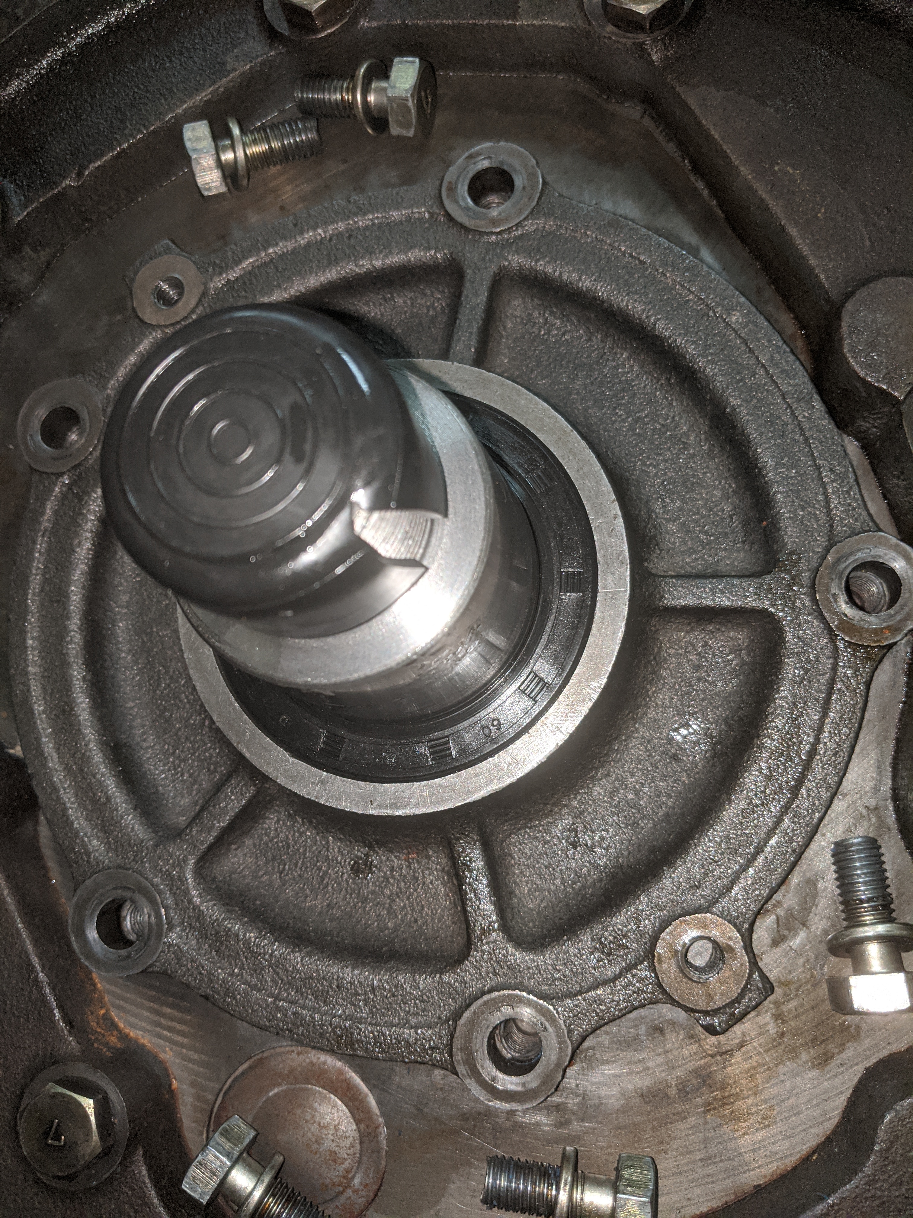

Which direction do these bearing go? I took pictures but I'm not trusting how it was put together last.
One side has a inside taper, the other side has an outside taper. Either way looks like the oil hole will line up with the oblong hole in the bearing. They were installed opposite the direction it seems like they would go if you go by the hole position. Does it even matter?

Also, what is the proper interpretation of "lip towards the front" regarding the seal? I keep second guessing my installation. IMG_20200813_204533.jpg
/ 2210 Main Bearings #4
...what is the proper interpretation of "lip towards the front" ...
To add to the confusion, Yanmar uses the marine convention of numbering cylinders starting from the flywheel end of the engine. 'Front' in that manual might be either end.

Thanks, so it looks like I have the seal in correctly.
27.5 ft lbs seems pretty light for how big these bolts are, but I'll run with that.
