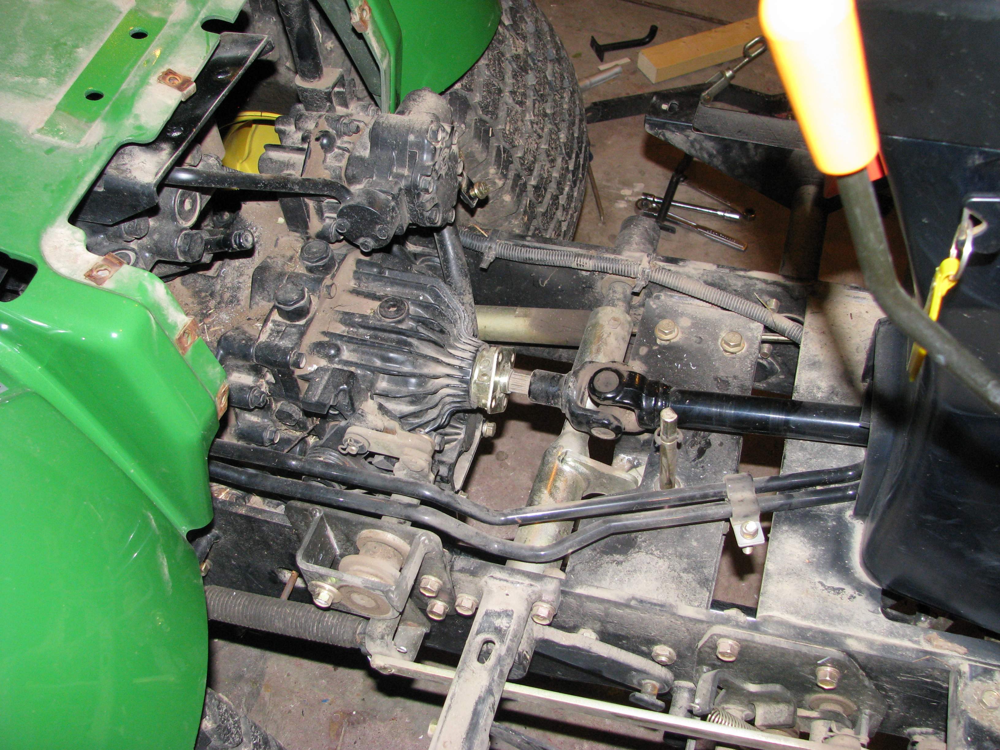

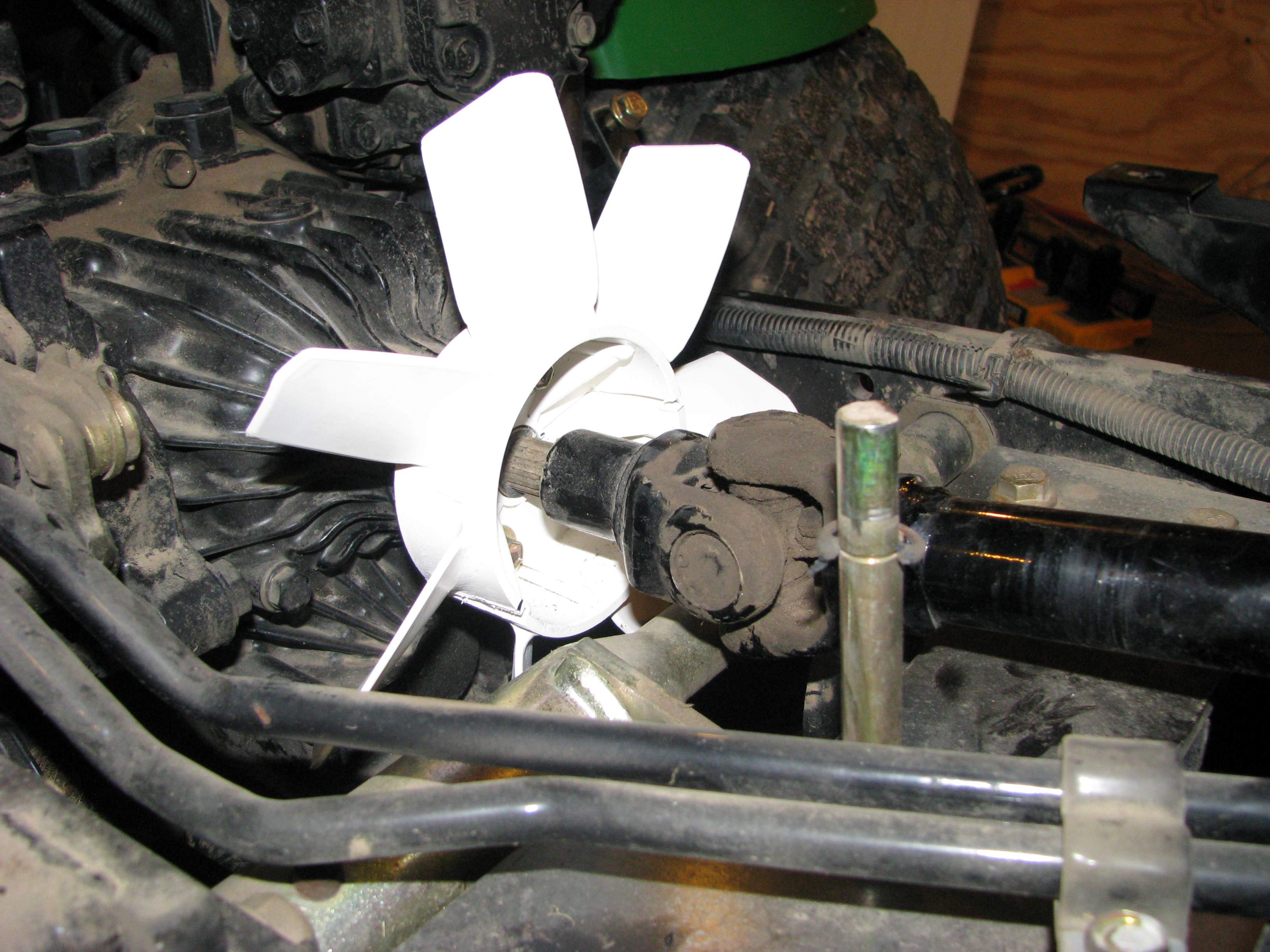

I replaced the hydro fan on my 2210 by cutting the fan as some have suggested and here are some pics. It seems to work fine. The fan does not flex even with the throttle wide open. I took the floor, fenders, and rops off. This made access to the fan easy. It took some time but there weren't any problems removing everything. You just need metric 10,13,18,and 19. 18 and 19 may require a pull bar because those rops bolts are tight.

Did you remember to grease the u joints on the shaft while you had it apart?
