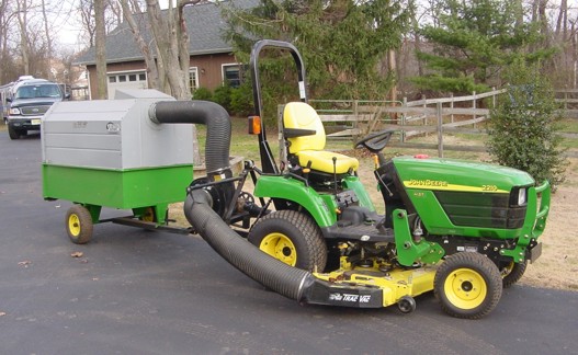

I'm running a model 854 3 pt. rear pto driven TRAC VAC on my 2210
and it works great. Taking it off and putting it on is fast and it holds 52 bushels of cutting or leaves.

Lobo,
Nice set up you have there. Could you tell me where you picked it up at and general price. Did you need to make modification to make it work with your equipment?
Thanks,
Bill
/ 2210 Factory Bagging System? #10
I bought my Trac Vac used, it was only 6 months and I paid $600.00 for it. The only thing I had to buy was a 62c mower deck boot, which cost me another $124.00. The former owner used it on a Kubota BX. Didn’t have to do any modifications for my 2210 at all, it went right on. This unit chops up what ever you’re vacuuming so fine, I figure I vacuum around a cart load of heavy leaves per acre and it never gets clogged. My father – in - law is running a JD power flow on he’s 2210 and this has twice the power of he’s unit. The price new on this system is $2500.00 with the cart. It takes me 10 minutes if that to hookup and go. Also you don’t have to worry about a gas pony motor for the blower or a blower running off your deck like the power flow.
