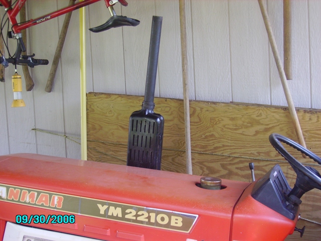

Gizmo36 said:
That is fix,
I suspect any tractor exhaust will sting your eyes on contact. I would recommend an automotive tailpipe extension to direct the smoke higher and away similar to a factory Yanmar exhaust.

/ 2210 burning my---
#39
I bush hog all day Monday and did not get the burning in the eye's like I do when I start it under the shed. But I am going to get a new exhaust for it .Because the exhaust is at eye level.I started bush hogging at 10 ran it all day till 6 It only use a little over 2gal. That is what I like about the 2cyl Yanmar.
/ 2210 burning my--- #40
I don't remember you saying anything about running your tractor under a shed . I guess that's why it would burn your eyes. I thought you were using the tractor (ie bush hoggin etc,.) when it was burning your eyes. WELL, glad to see it & you are ok now
