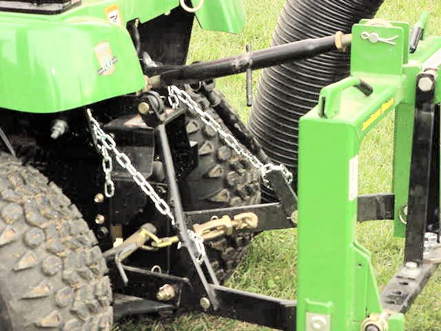

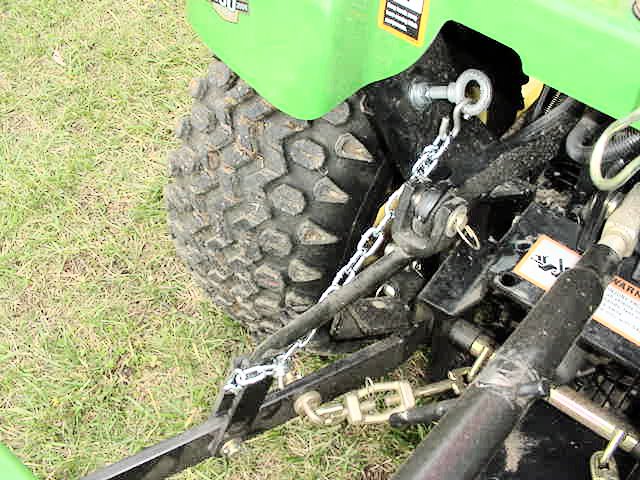

While I am mowing my 3pt arms keep dropping down and annoying me. When I back up they dig in the ground. Is there anything I can do?
/ 2210 3pt arms #2
I added chains to mine. It also worked as a kind of position control.

I believe 35DMAN is having the same problem I had with the 2210 I used to own. The arms will settle as I would mow. Before I added the chains I had to keep track of how low the arms were & keep raising them.
