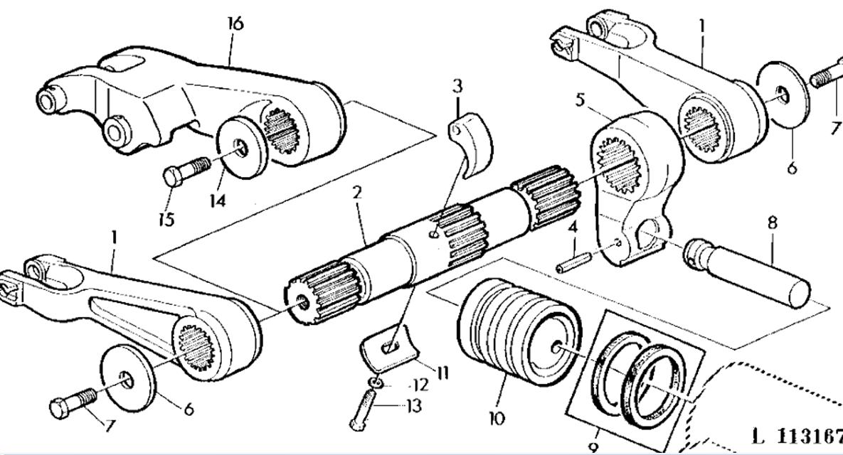

Looking for some help working on a 2140 X-E SERIES.
There is oil leak from the shaft that goes through the rear housing for the lift arms my question is can this shaft be pull out to put in a seal or is there something on the inside of it?
Has anyone any manual, diagram or picture would be much appecated.

But it is the bottom shaft .the one the arm come of.
Regards
Brendan.

Bottom shaft is the torsion bar and these seals are a frequent problem with JD's

The shaft he is referring to is a torsion bar that will bow ever so slightly in propertion to the draft load. It does have a lever attached to it that adjusted the hitch valve, this is part of the load and depth control feature. Seems like all of these leak a little that I have seen.
No, it does not come out easily, it is attached in the middle of the shaft.

I was wrong about the pall being connected to the shaft, it only contacts the shaft when flexing. I would think you can change the seals on the ends if you are willing to drain the case.
Hope to post a pic for you. If you go to the section above you can see an illustration that will be helpful to you.

Thanks for pinpointing the location of this shaft.
Might also change out the 0-rings. Looks fairly easy to do.
Looked it up, and here is illustration.

There are a couple of variations depending on the model, but they are all similar. Some have the flanges on the ends, some don't but they all have seals and/orings to refresh.
