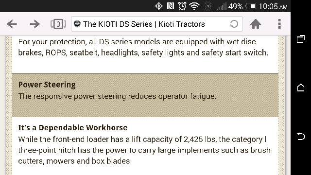

I also noticed that they changed the front loader lift capacity. When I was shopping a couple years ago, the loader had the same specs as the DK loader, now is down by about 400lbs.
As far as I know the loaders are identical except for the mounting. Same loader arms, cylindars and running the same pressure. At the Kioti website and in my Broshures they both have identical lift capacities. I do remeber reading a lower capacity somewhere and think it must be a mistake because it is inconsitent with everything else including the physics (same pressure, cylinders, geometry has to equal same capacity)
Curious - where did you see the lower capacity numbers?
It's odd, they describe it in the general description, but when you go to the loader spec page, the number is 2761 again. Must be a typo in the description.

I checked my loader owners manual and it also has 2761; same as the specs at the Kioti site and in the Broshure.
