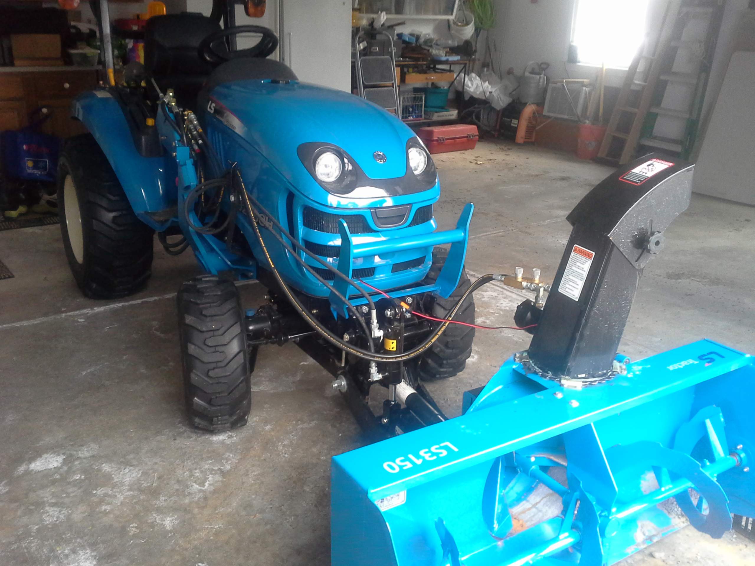

Just discovered similar issue on my J2030 with 42 hours on the meter. Dealer is going to pick it up and try to find the leak (somewhere in the hydro area). I thought it was a simple filter seal but they sent a tech out and he says it has to go in to the shop-- doesn't sound good except that I won't have any out of pocket costs-- just have to figure how to keep my 850' driveway clear of snow for a week or so. Harder than you think since I live just south of Lake Ontario so we get a lot of lake effect stuff.
I'm going to give my dealer a heads up on your issue- may save him some time- Thanks

Sounds like your leak and mine are very similar- supposed to get a call about when they will pic it up to fix- stay tuned-
BTW I "blow" snow
/ 2030 hydraulic leak
Nice set up. Beats a shovel.
