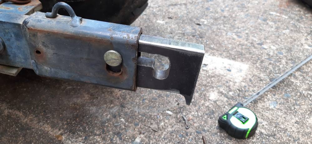

I have the Pats and added a PTO shaft extension, it was not necessary but made connecting the PTO shaft a lot easier.

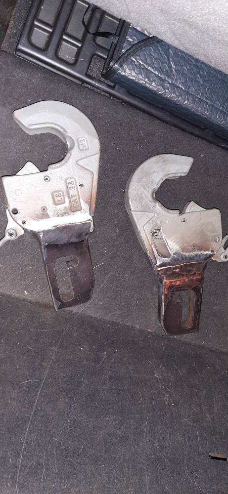

To be clear, Euro draft link ends are weld on only. Pat's are bolt on only.
Pat's and the Euro ends ARE NOT the same, not even close.

I liked mine, unfortunately I didn't get to enjoy them long before my box blade broke them.View attachment 2167191
I had the same result to one of my welded on euro hooks. I was box blading with the scarifiers down. I contacted an immovable buried boulder and snapped the hook. I was using the Cat. 1-2 hooks. I subsequently purchased the Cat. 2 hooks as replacements, but have yet to get them welded on. Their beefier size gives me confidence, but I'm still considering using the ball mounts only, while breaking ground with the box blade.
I purchased a replacement set of OEM ball ends to use after the break, because I had cut the original arms for the weld ons.
