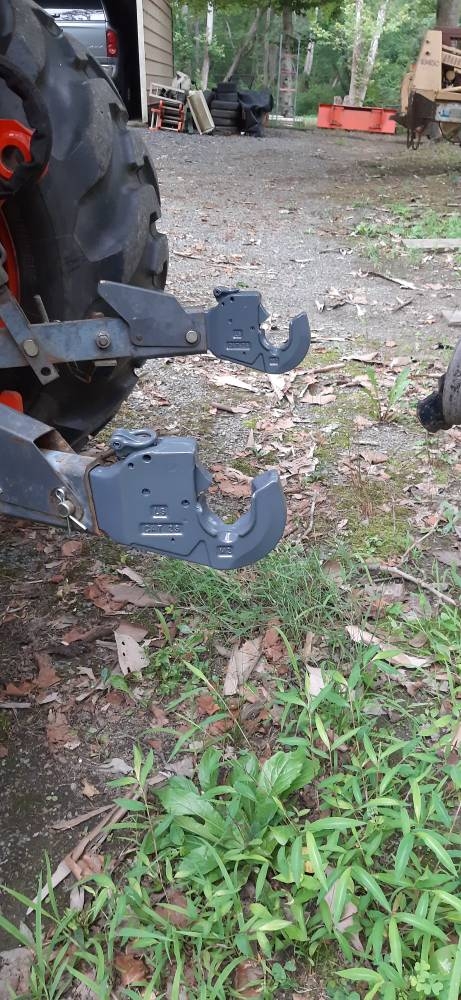

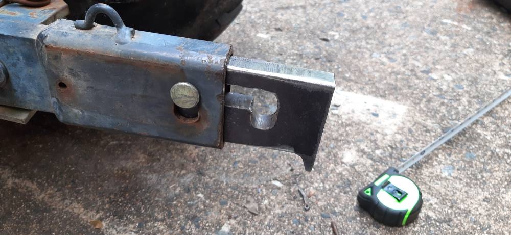

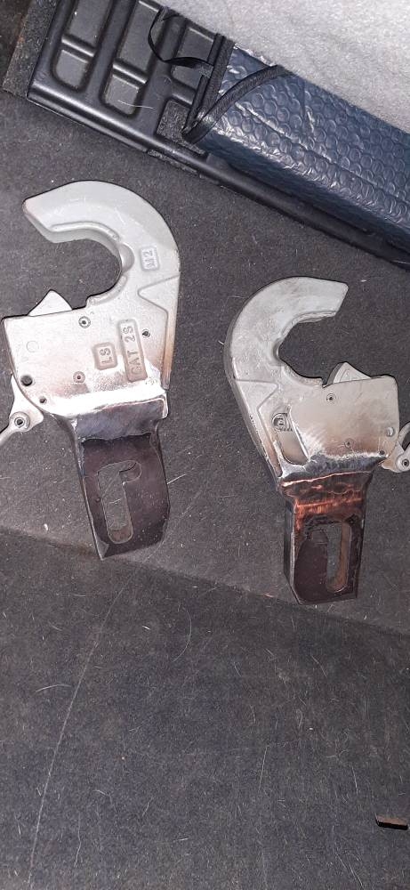

I see nothing different on how the Euro mounts work than how the Pat's QH works. They even look the same. And you have to cut off part of the OE equipment and weld new pieces on. I absolutely love my Pat's hitch and see absolutely no advantage here.... What am I missing?
I had Pat’s on my last tractor and enjoyed having them. I have no quick hitch on my current tractor because the telescoping lift arms make it easy to attach implements. The only difference I see with the Eurohooks that make them better is the balls that swivel a little better than the Pat’s system. The hook part appears to be the same.
Looking at the video i watched, they appear the same. The issue was that it was very hard to keep the Pats from rotating since they are bolted on. Also, the Pats added more length to the arms. Probably never sn issue, but its a point.

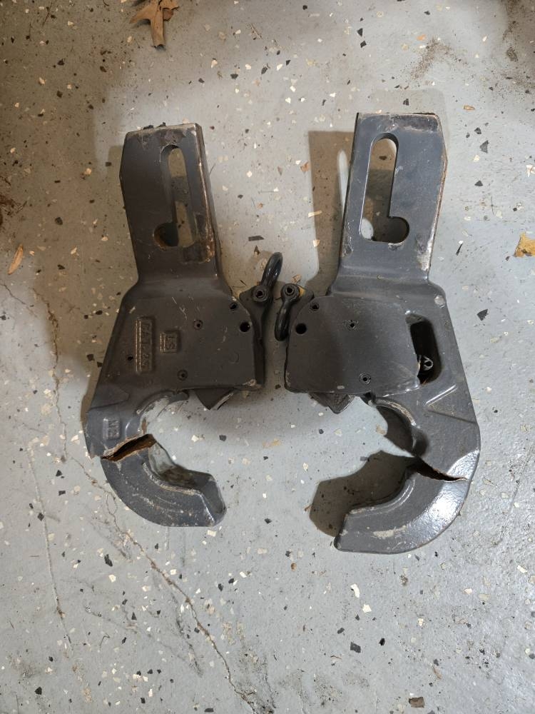

I liked mine, unfortunately I didn't get to enjoy them long before my box blade broke them.

I liked mine, unfortunately I didn't get to enjoy them long before my box blade broke them.View attachment 2167190View attachment 2167191
First time I ever seen these fail. Like the other members, I'm very interested to know how this happened.
The hardest time mine have is when I'm using my subsoiler. I had it buried all the way on the ground, while the subsoiler pulls the tractor down which provides even more traction and haven't had any issues with the hooks.
