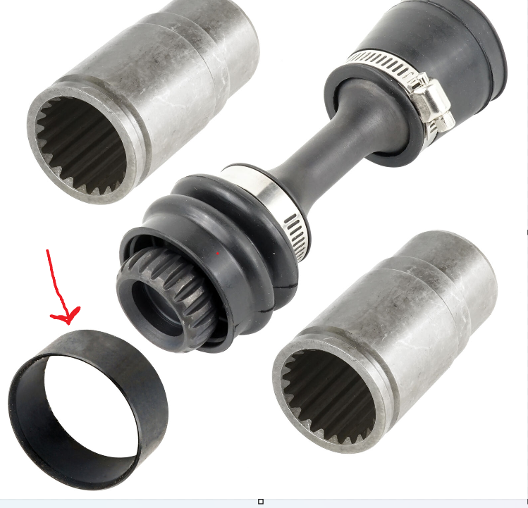

This shaft, I had pictured this when you mentioned this issue last season as one of the front wheel drive shafts. Clearly it's not. Where is the shaft, between the engine/transmission and the front rear axle? Or is this interaxle between 2 rear axles that I thought the rear most axle was chain driven from the front (rear) axle?
Front rear, rear front terms don't make for good reading. 😆 I hope you understand this dribble.
Its the front drive shaft, BRP calles it a propeller shaft that it drives the front differential.

So this is the new part? It will help how?
   / 2022 Outlander Max 6x6 #284
You said the photo shows all the parts. The red arrow is pointing to a part. Is that it?
Or is it more like a 1/2" thick hockey puck?
#285

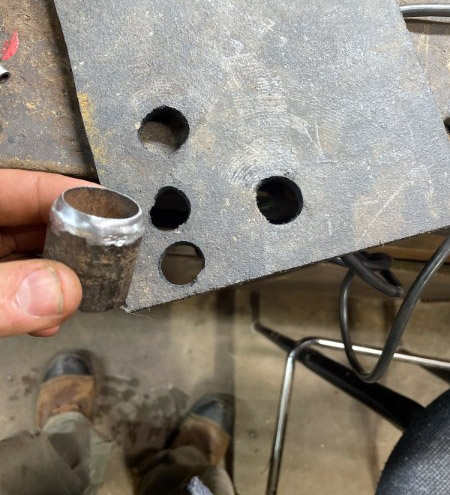

The kit shows all the part to replace the front propeller shaft. We only needed to take the shaft off to add the limiter.
   / 2022 Outlander Max 6x6 #286
So the limiter is a homemade part that is like a 1/2" washer or hockey puck to limit how far the shaft can slide?
#287
Its 1/2 thick. He thought that 5/8 thick might have worked but this thickness barley got together. This 1 inch wide plug was put in the rear coupler to limit its rearward movement.
