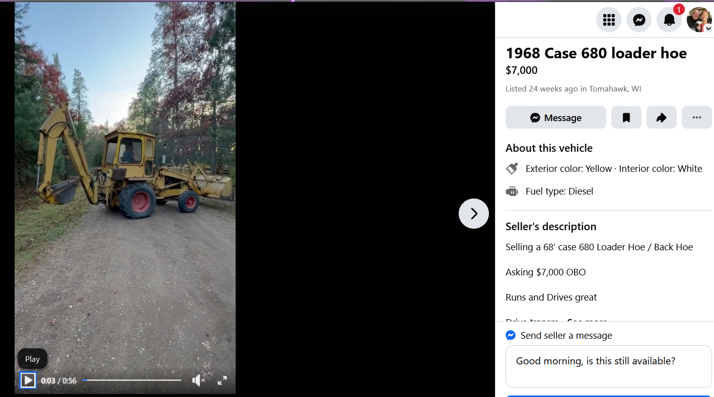

There are three schools of thought on a backhoe
  1. Buy a Backhoe attachment for your tractor
  2. Buy or rent a Mini Ex
  3. Buy A a used Industrial Tractor Loader Backhoe for about the same price as the attachment
I like option #3

Knowing what I know now, after buying my brand new little TLB during the "supply chain" crunch ... And four years of ownership ...
I would have been much better off buying a used real backhoe, the kind that usually has a shade of yellow paint, or even a 2.5+ ton mini-X ... I just didn't really understand the options and capabilities ... I had never even used a BH before I bought mine.
I had 800'+ of ditch to dig, put in three culverts, I couldn't get a contractor to even return my calls, I had to get my driveway area drained and more product in, ended up buying just under a million pounds of rock and gravel ... A real construction grade piece of equipment would have made it much easier!
However, I'm quite heavily invested in my little homeowner grade TLB, and don't want to sell or replace it ... I'm quite satisfied with it limitations, for my use it's working out, soon to be retired and time won't be a consideration.

If you have 2 people, one to operate tractor and one to operate backhoe attachment, it works pretty good. One person doing both? Climb out of cab, climb on backhoe, dig for a few minutes, climb off backhoe, climb into cab, move tractor(10 feet or less), climb out of cab, climb on backhoe……..IME, you’ll be worn out before you get very much ditching done.
IMO, An older 4wd Case (580 series) or JD (310/410 series) with a 4n1, extendahoe and thumb would cost less and get the jobs youve described done. Bigger, yes. Intimidating, kinda, for a couple of days.
