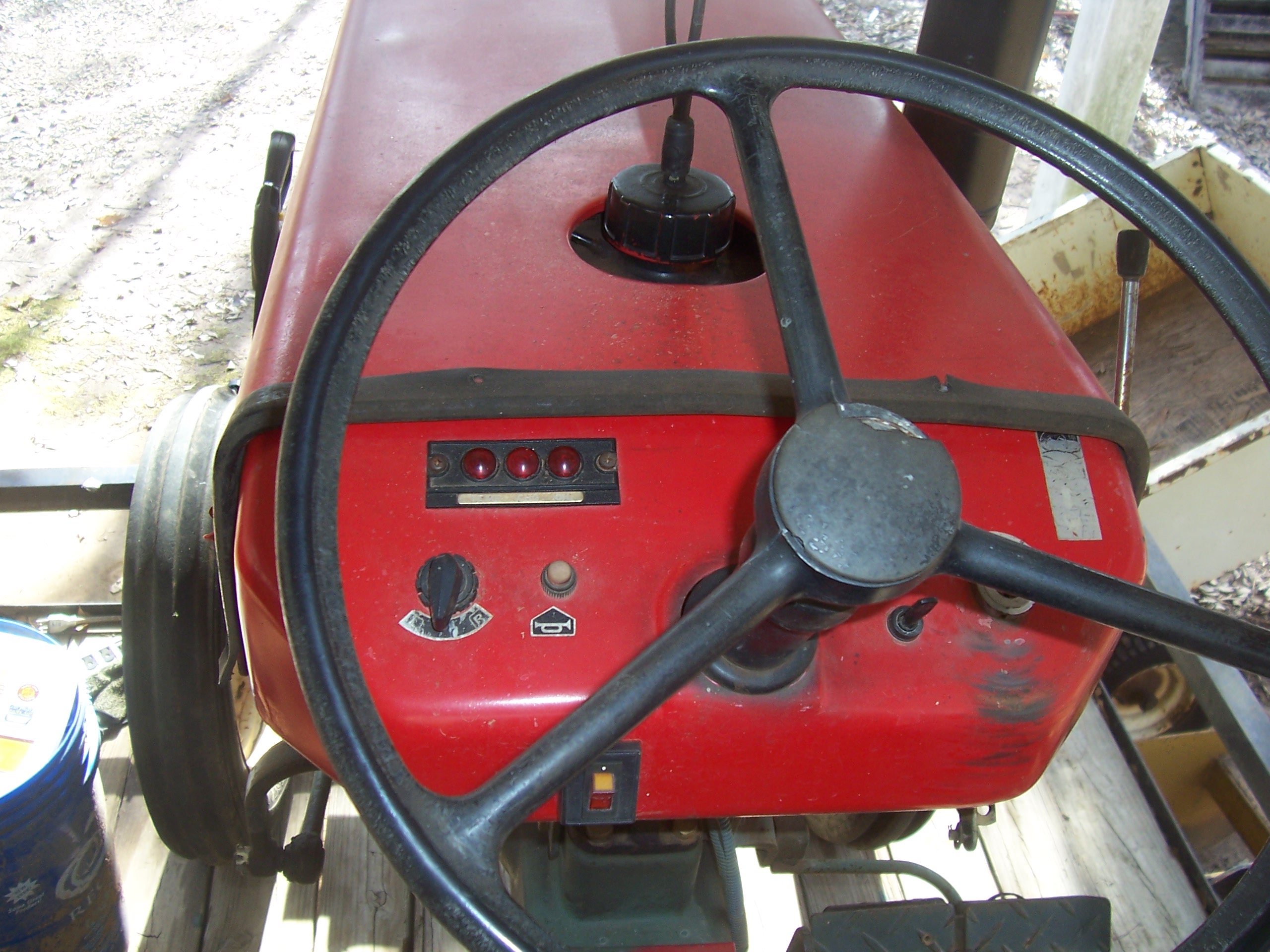

Steering wheel And the Tire Cracking came up when I bought it. A couple axel wheel seals been about it. No doubt this was a true rice patty tractor. Still Org. Front ligts and rear lamp all work as they should. Just no Blinkers, Horns still good though. So pitiful it's comical. They showed wear Yrs. ago.
