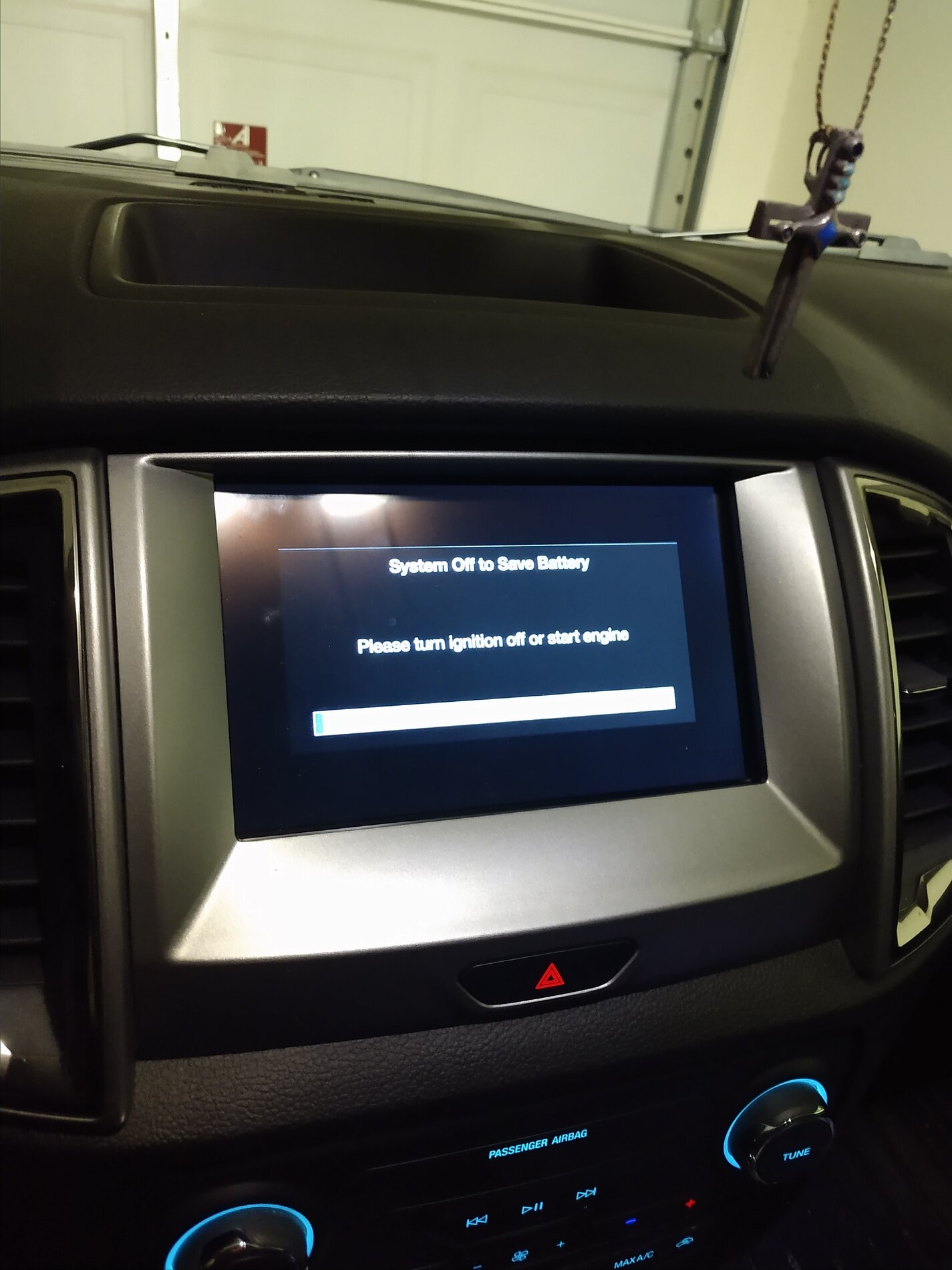

Getting this warning when we get in da truck.. Time for a new battery? Anyone else see this?
   / 2019 ford ranger review.... #935
Getting this warning when we get in da truck.. Time for a new battery? Anyone else see this?View attachment 832035
I see this on my hybrid car sometimes when I park it at a point the battery is low on charge. I would suggest just giving the battery a good slow charge. Cars have so much electrical load now that if you don't drive long distances at speed, the battery doesn't get fully charged. I charge my F150 every six months or so and it takes quite a while to slow charge fully. It also usually hasn't gone into start/stop mode for the last few years, probably because the battery isn't sensed as fully charged. The truck and battery are about 7 years old. Don't panic. :)
   / 2019 ford ranger review.... #936
What year vehicle? If the battery is over 3 years old and you drive the truck frequently, then yes, the battery could be starting to fail.
Our F350 sometimes sits in the garage for 2-3 weeks unused and I started getting the notice on my phone in the FordPass App "Remote features disabled to preserve battery" around 3 years of age eventually one of them lost a cell and had to be replaced.
However, I have also received the same notice after the truck sat for 3-4 weeks unused and the truck batteries were on a battery tender and it indicated fully charged.
#937
Its a 19 and has 50K miles on it. Seems it might be a agm in it.
   / 2019 ford ranger review.... #938
..It also usually hasn't gone into start/stop mode for the last few years, probably because the battery isn't sensed as fully charged. The truck and battery are about 7 years old. Don't panic. :)
That is one of the criteria that will prevent stop/start mode from working so yeah, you probably have a battery failure looming.
   / 2019 ford ranger review.... #939
Hmmm, Our F350 is a 2019 as well, purchased in June and batteries had to be replaced 5/2023, right at 4 years.
   / 2019 ford ranger review.... #940
True, but it seems to be looming very slowly. It's been going on for about three years now.
